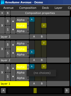

Is anyone else seeing this - running XP Pro.

Have you tried clicking on the little down-pointing black arrow next to the blend modes? That opens up a menu of a bunch of different compositing modes. You can replace the three blend modes with any of those from the longer menu.

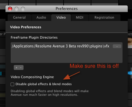

Posts: 2240
Re: Layer Blend Modes... no choices
Did you disable the global effects and blend modes in the preferences?
This is makes the engine a lot faster on high resolution but obviously disables the global effects and blend modes ;-)

gpvillamil wrote:Have you tried clicking on the little down-pointing black arrow next to the blend modes? That opens up a menu of a bunch of different compositing modes. You can replace the three blend modes with any of those from the longer menu.
It clearly shows in his photo that he is clicking on the arrow and it is not showing any menu choices. :(

Ok - it wasn't a bug it was an option -
- yes inadvertently I had done this ...
