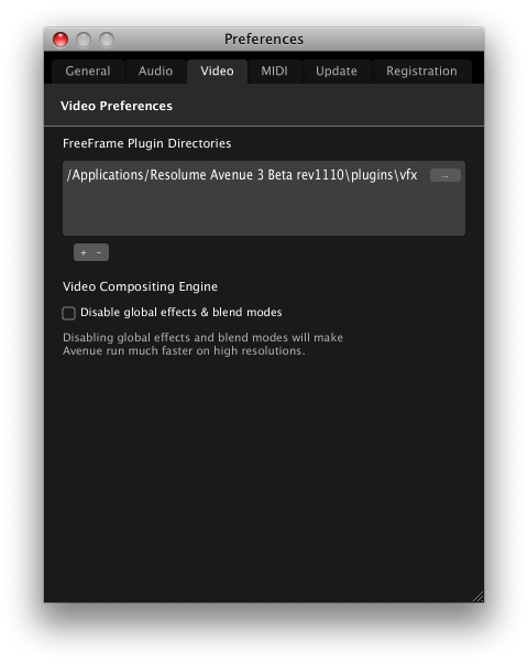

Posts: 2240
Re: Performance!
You can make the Resolume video engine run much faster by disabling the global effects and blend modes in the video preferences.
Picture 2.png (53.34 KiB) Viewed 13161 times
HerrNieDa
Posts: 470
Joined: Thu Oct 02, 2008 09:30
Re: Performance!
Post by HerrNieDa »
but the Blend modes :shock: :cry:
can't mix without then ;)
but i will try what it if it runs better then and report ;)

just tried without blend modes and global effects, really runs okay ;)
