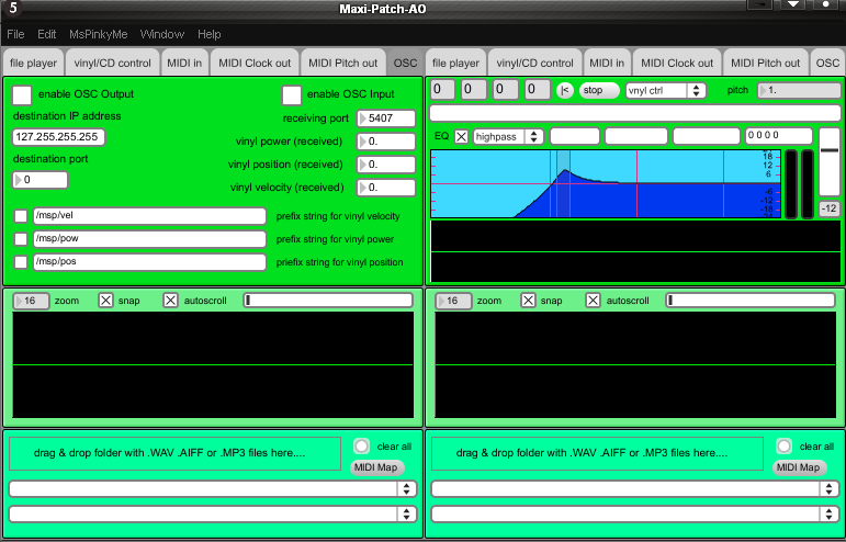

HI, I've never used osc before and am trying to use time coded vynil to scratch a clip, can anyone give me some advice, I've spent some time on it already but not gotten anywhere.
The tcv app I'm using is ms Pinky, the osc output settings tab in Pinky looks like this, the address of the perameter I want to control is /layer/clip/video/position/values f
Thats as much as I know, what do I do next?

At a guess get rid of the speech marks and the f.
Otherwise, use an OSC Monitor and compare output with the processing example. I posted a few pointers on the VJ Forums.
As Tom said you've got to check that Pinky sends an output between 0 and 1 - can't remember if it does or not.
If not you'd need to alter the Maxi Patch using Max/Msp.

Somehow this thread slipped through without me noticing, been away for a few weeks and just stumbled upon it.
The OSC address is almost correct, but you need to specify which layer and which clip you want to control
So this would be a sensible adress, the 'f' means that it expects one float as argument.
/layer1/clip1/video/position/values
