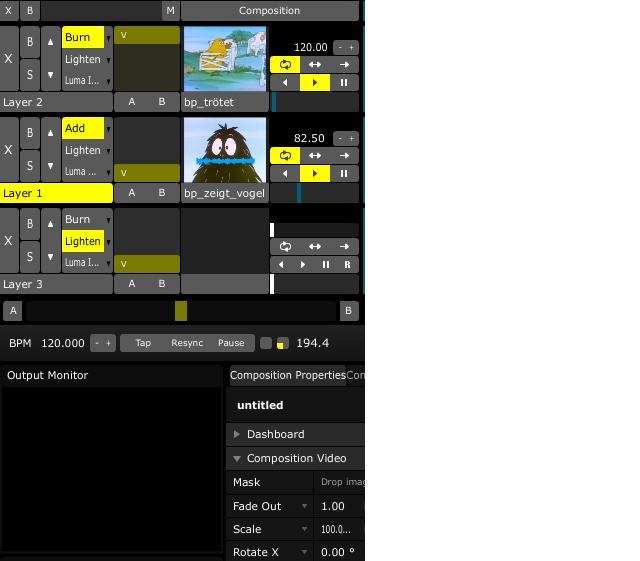

Hey,
using the Burn transition at the upper layer when the lower layer's opacity is zero I get a black output. When I increase the opacity at the lower layer I see fragments of the lower layer in the output (even if the upper layer's opacity is at 100%) - can somebody reproduce/confirm this?
System:
Vista32 / GeForce 9500M GS
Codec: tried with
DXV with uncompressed Audio and
M-JPEG (.avi) also with uncompressed Audio

Rene
Posts: 388
Location: Vienna, Austria
Re: Burn transition --> black output
Post by Rene »
thanks for testing everyone! ;)
I totally agree with syzygy about the demo footage thing. Just tried it with the demo footage on Vista32 SP1 and XP SP3 on both systems exactly the same bahaviour. (as described before) :(
next I've checked my drivers (I should hae done taht before, I know :roll: ) (as far as I understand the latest omegadrivers (nvidia card with xp / vista) do not support notebooks - pls. correct me if I'm wrong) and found a new version (feb 2009) at the nvidia website (179.48_notebook_winxp_32bit_beta) (beta!) - after installation it seems to work! :) Also the Vista version of the driver fixes this opacity issue.
