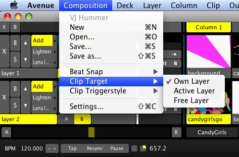

We are very curious to hear from you all what your favorite Clip Target in Resolume 3 is. Clip Target is a very powerful but to many unknown feature that allows you to work in very different styles.
Do you prefer it the default new Resolume 3 way (Own Layer) or do you like it Resolume 2 style (Active Layer) or do you prefer the new Free Layer style which allows you to work without even worrying about the layers. Or do you have no idea what this is all about?
If you have no clue what Clip Targets are then this bit from the Resolume 3 manual will be helpful:
Clip Target
The default thing that happens when you click a clip is that it plays on the layer it is held in. You can also set clips to play in the active layer (this approach will be familiar to Resolume 2.x users) or even to use the next available layer.
Like Beat Snap and Trigger Style, you can change this setting for the whole Composition (Composition > Clip Target) and for individual clips (Clip > Clip Target)
The Free Layer Clip Target mode is particularly fun when used with the Piano Trigger Style mode (see above). You can then play 'chords' of clips with the keyboard or a MIDI device - each of them will be displayed for as long as it is selected. Obviously, you will need as many layers as you want to play simultaneous clips.
