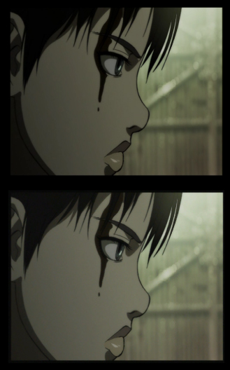

2) When rendering the same clip with DXV or another codec (I did several try with DivX, lossless, other) I noticed that the DXV version is brighter than the others and thus is brighter than my original. Is there some kind of auto-contrast or auto-brightness feature in DXV? If yes, I would appreciate to have the possibility to deactivate it.
Please see attachment: top : "any" codec / bottom: DXV , screenshoted from R3 preview (but I noticed exactly the same difference when playing in other players)

We will have a look at the Brightness issue, could you send us the original file so we can test and see for ourselves? mail to mail At resolume.commandawah wrote: 2) When rendering the same clip with DXV or another codec (I did several try with DivX, lossless, other) I noticed that the DXV version is brighter than the others and thus is brighter than my original. Is there some kind of auto-contrast or auto-brightness feature in DXV? If yes, I would appreciate to have the possibility to deactivate it.

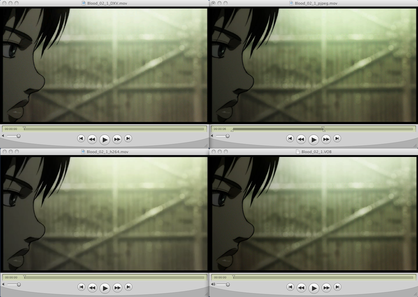

Re: DXV rendering: perenity / auto-constrast?
Thank you for sending the file to us. I've done a test too and got the same results. I,ve also rendered the file to h264 and photo jpeg. Those are also a little bit off, Photo JPEG 85% is a bit darker. I'm actually surprised how poor h264 looks, the image has a lot less depth and looses a lot of subtle colours eventhough I set the quality very high, to about 90%. Interesting!
Yeah, I have experienced this issue too. I have noticed some brightness changes when converting from pjpeg to DXV. . Each codec encodes the color information differently. Unless lossless each codec will try to remove "unnessary" information to compress file space. I'm not surprised that the H.264 video looks the worst since it has the highest compression. pjpeg codec I assume only compresses each frame as is, and does not look at temporal redundancy (similarity between frames) like H.264 or any other MPEG.
DivX is a type of MPEG4 codec and does take into account temporal redundancies. Thats why it has such small files sizes. it reduced the color information based on frames over time and space. The downside to this is speed. I think pjpeg, mjpeg and dvx do not take temporal information into account. Instead it makes every frame a key-frame with full data, that is not dependent on color information from other frames. That is why you can scrub it back and forth quickly. Each frame is an independent image that can be quickly loaded, even though the file sizes are bigger. H264 and DivX on the other hand take more cpu power to decode, even though the file is smaller. That is why its clunky when you try to scrub it back and forth since the processor is constantly trying to read more then one frame of data at a time. great when playing at normal speed, bad for vjing. The real power behind DXV is that it lets the GPU not the CPU do the decoding. well at leased it does when you use it with R3.
I think your going to get color/brightness shifts no matter what codec you use other then going lossless. Each codec is going to try to compress and simply the information in its own unique way resulting in a shift/change in color/brightness. I don't see a way around it.

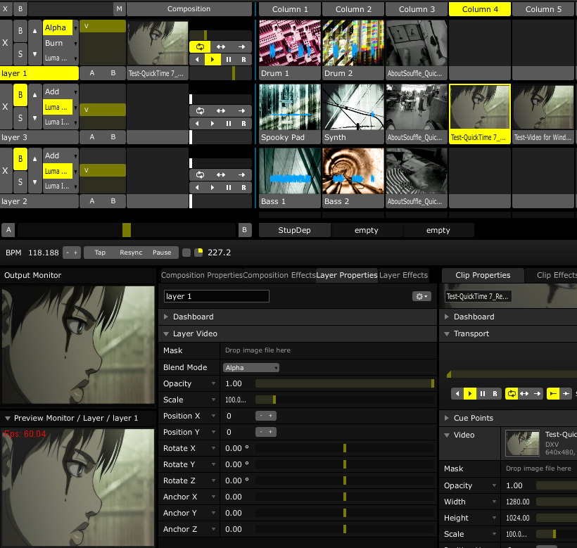

Hi there,
More input on this "DXV Brightness" subject.
[But before let me just say: you Resolume guys are crazy: I just made a few test with 1080 DXV mov files: I have been able to mix 3 of them (did not test with more) with Luma-key composition, resizing, synced with bmp, etc.: The ouptut at full res was 38fps with 2 screens! I am amazed, this thing rocks!]
Ok: please have a look at the (partial) screenshot below. As you can see Layer 1 is 100% opacity with alpha. I thus expect the output to be identical to the clip itself (it's the DXV version I am playing), but:
- The brightness of the Preview monitor is even lighter than the "output monitor".
- The "output monitor" colors are very close to the DXV clip colors when played outside Resolume.
- On my second screen (fullscreen output), the colors are similar to the one of the "output monitor" window.
So basically it seems that brightness of preview monitor is not exactly right.
Again this is not really annoying, but I thought you might like to know this.
