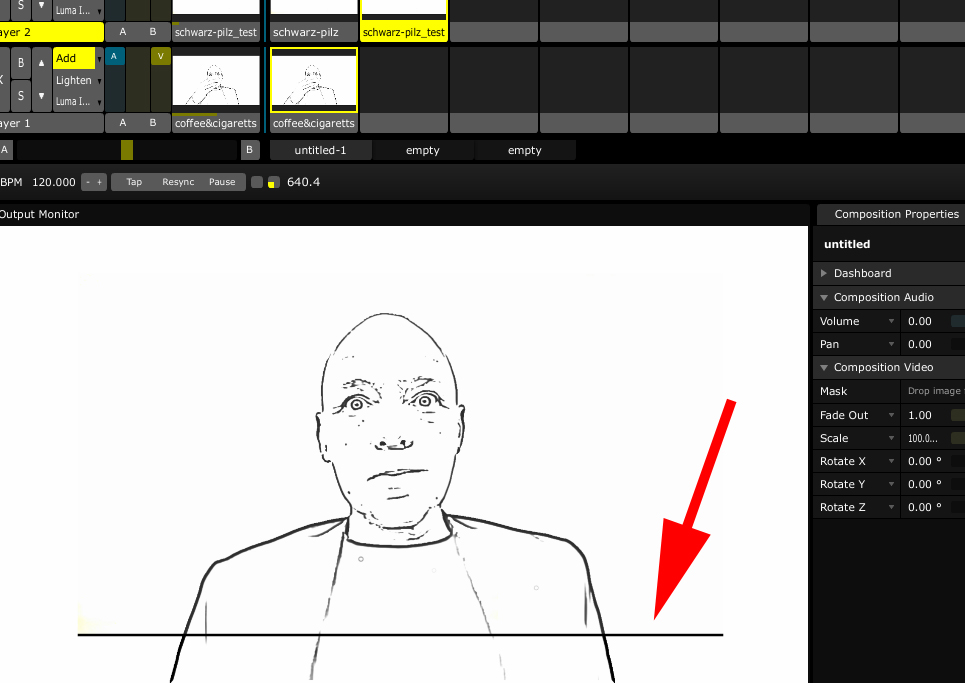

I just started using resolume and got some problems importing quiktime files. I hope you can help me, i havent managed to find any answers to this problem till now...
Im editing my video files - Shot on a CanonEos5D with - AECS4 - exporting a Quiktime in 1920x1080 with a H264 Codec... While using this files in resolume a thin black line appears at the bottom of each frame while scaling them down....
Is there any simple solution for this ?
(heres a picture)

Slim Black line....
Slim Black line....

hey... just tryed to render a DXV - same shit different colour... the problem with the thin black line at the bottom still appears...
here´s a sample....
http://filebase.to/files/1058834/schwarz_pilz_dxv.mov
could it be a matter of the pixel shape ? (like cubic..) or the safeframe or underscan ?

Ja we discovered this also on a different movie this afternoon, we're working on a fix, can you email us on mail@resolume.com so we can send you a fixed version for testing?

Hm I've run in to this problem too...
At first I thought it had something to do with the DXV codec, but now I also see it using the mjpeg codec (in avi files). I render practically all my video files with AE CS4, so it might have something to do with that, or it's a problem with Avenue. When I import the rendered file back into AE, and put an offset effect on it, the black line clearly shows up. (In Avenue, the most obvious effect to show the black line at the bottom is Slide)
I also tried rendering them in 1024x768 in stead of 800x600 because I read somewhere on the web that it might have something to do with 600 pixels not being dividible by 16, but it still showed a line
edit: hm, i've setup VFW to use the mjpeg codec from libavcoded, and the problem doesn't show itself anymore except in Avenue... I can't really see if the line shows up at the bottom of the video when I don't use slide, so I can't really conclude that it has to do something with the Slide effect or just the way it outputs the composition...

Re: Slim Black line....
The black line problem does have to do with the fact that sometimes the width and or/height are not dividable by 16. We are working on a fix and hopefully this will be included in the next release.
