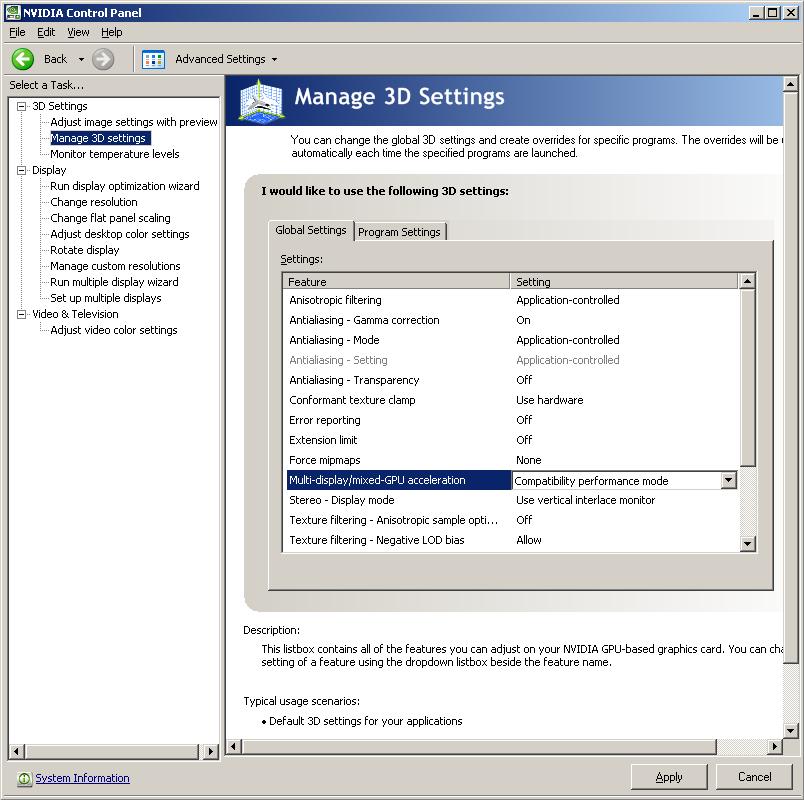

I am using 2 gfx cards (nvidia 250 & 285). The 250 is for the interface and the 285 for the output, I am having no luck getting it working. The only time the video will play on the output is when it is in windowed mode and part of the window is on the interface display. Alternately, if I use the 2nd output from the 250 there is no problem, the video works fine. I have installed the latest drivers from nvidia.

On Windows 7 this will work fine, on XP it does not unless you set the videocard drivers to 'Compatibility performance mode'.

Thank you! Now to try 2 th2go's today! do you think I may be able to run a third th2go on the 250? might be pushing it ... i do have 2 ssd drives and 2 regular drives to distribute the video streams.
