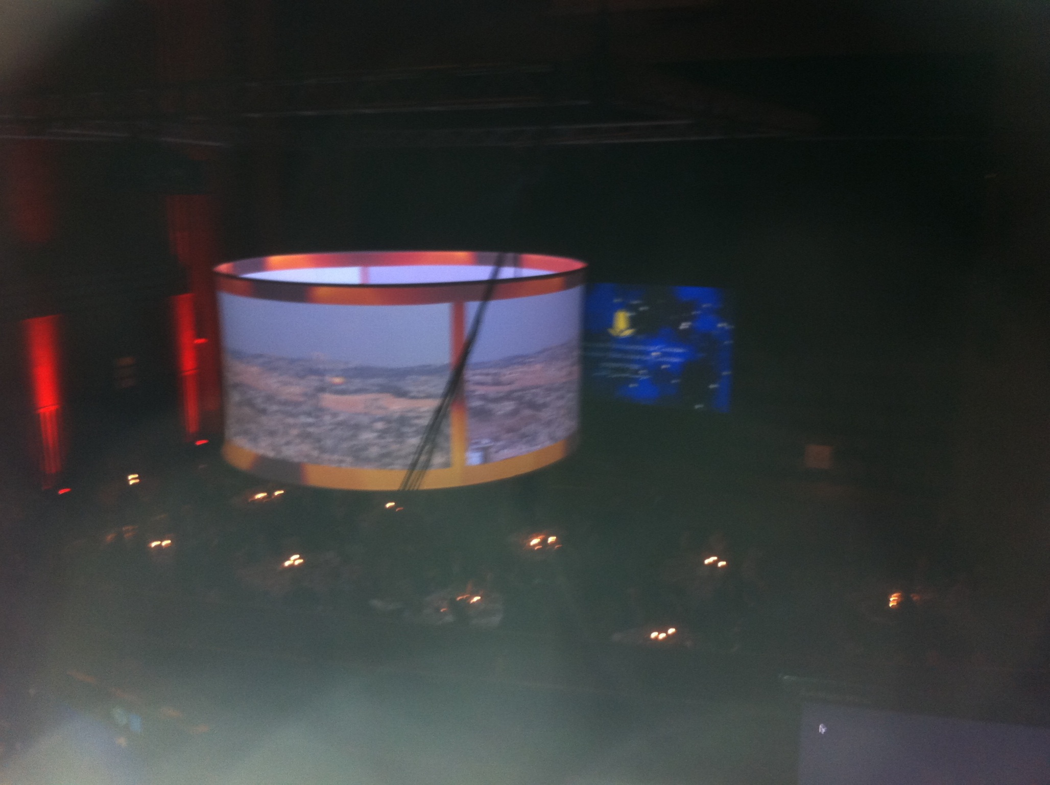

One of the show setups I would like to implement the Arena Version of the software is on a 360 degree surface. The setup consist of 4 projectors that are edge blended and geometrically corrected to compensate for the curved surface.
Here is a pic of one the previous setups I'd using modified quartz compositions and VDMX
Ring Screen
Ring Screen

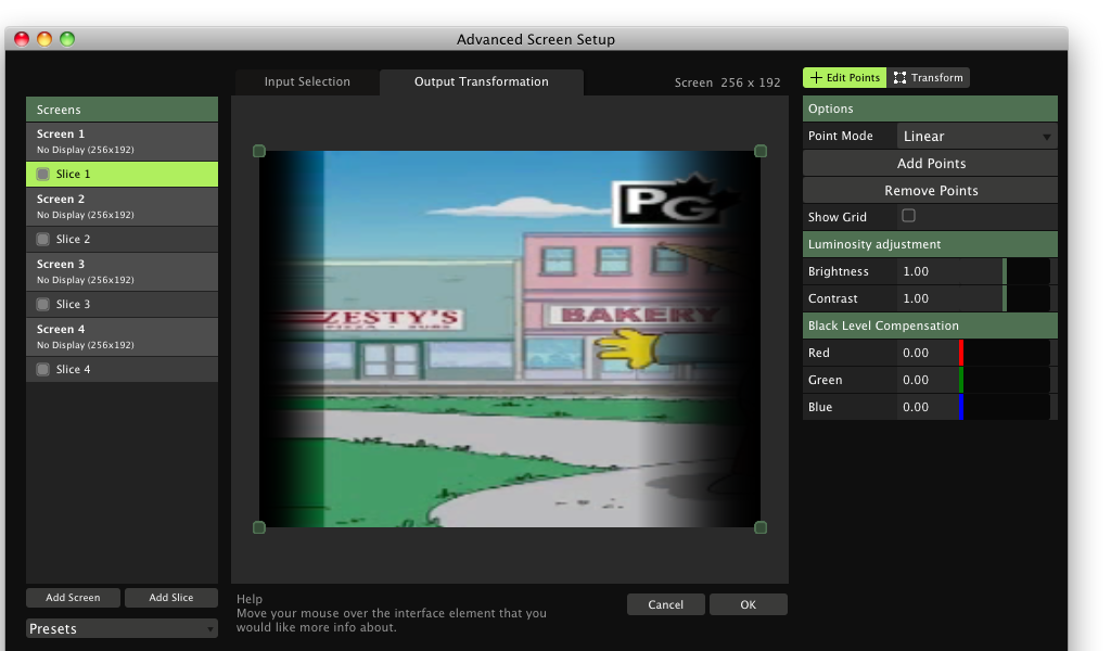

I tried this yesterday and found that it creates stretched horizontal lines on the side of the slice.
Projector 1
Projector 1
Screen shot 2011-10-05 at 12.15.21 PM.png (219.69 KiB) Viewed 25415 times
Input
Input
Screen shot 2011-10-05 at 12.21.58 PM.png (132.26 KiB) Viewed 25415 times

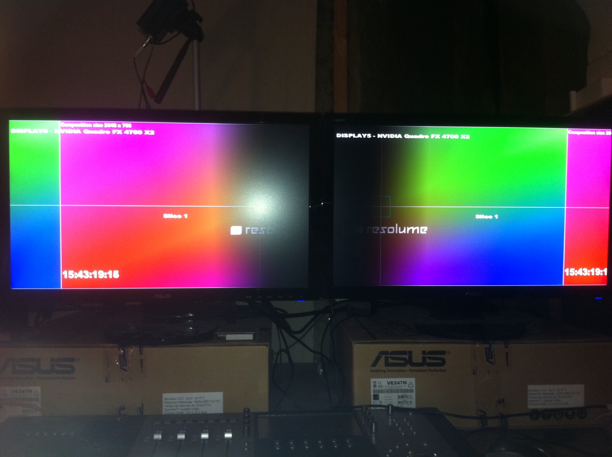

Today I've been testing on a Windows 7 computer with a Quadro FX 4700x2 card with moitors attached to all 4 outputs. I'm only using 2 outputs at 1024x768@75 to test that the edge blending happens for 360 degree projection.
I do not see the same horizontal stretches on the far sides of the image like I did in OS X (intel gpu)
However her are my observations
As excepted not enabling wrap only blends the center slices where they are overlapped

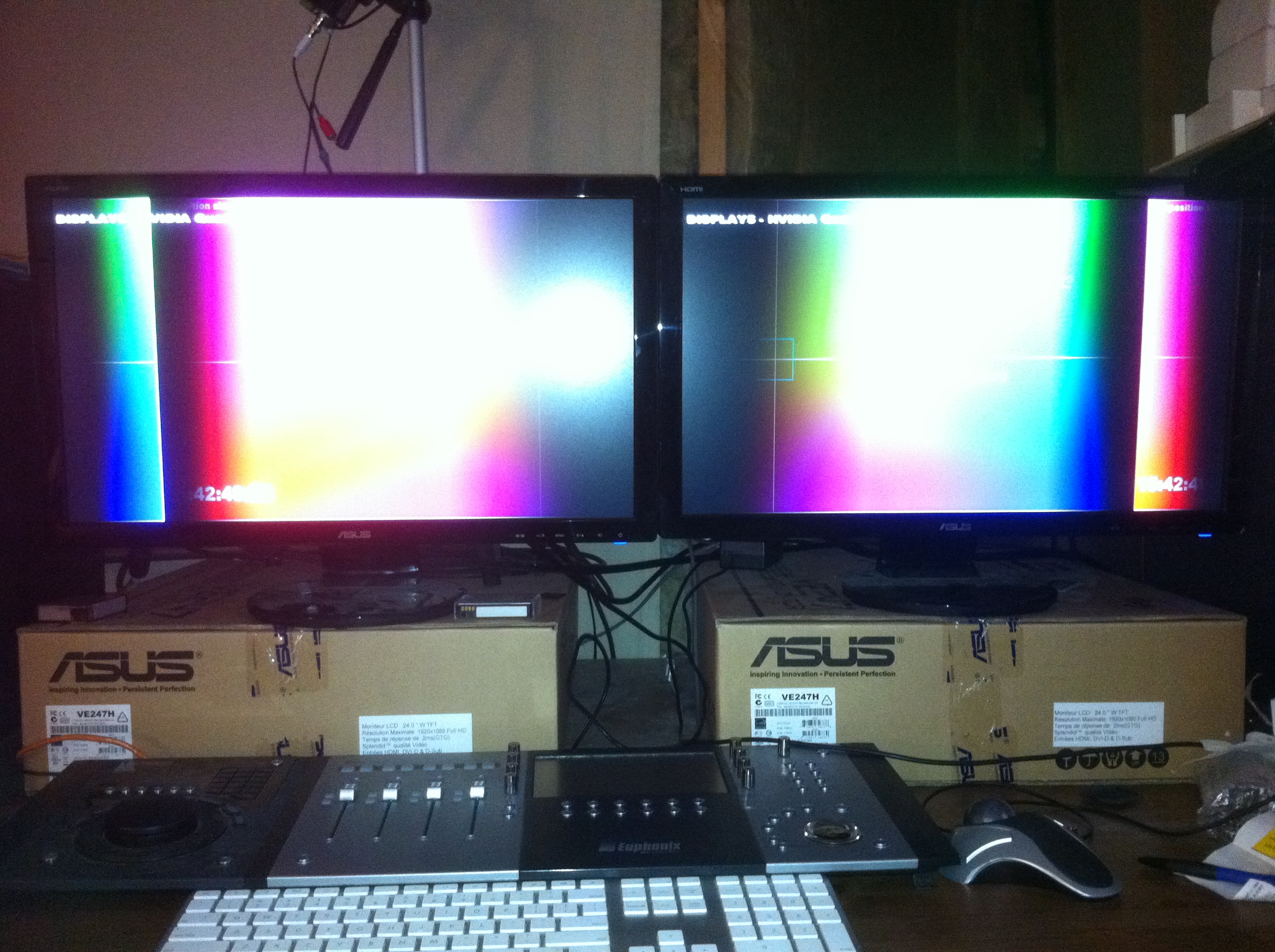

Having Wrap enabled on both slices and extending them past the Composition area does wrap the video around both sides however it does blends the outside edges twice (ie on the far left of the screen and where the blend stops until I click on Advanced Output contol window. After I click on I lose the blending on the outside windows.
Double Blend
Double Blend
After OK
After OK

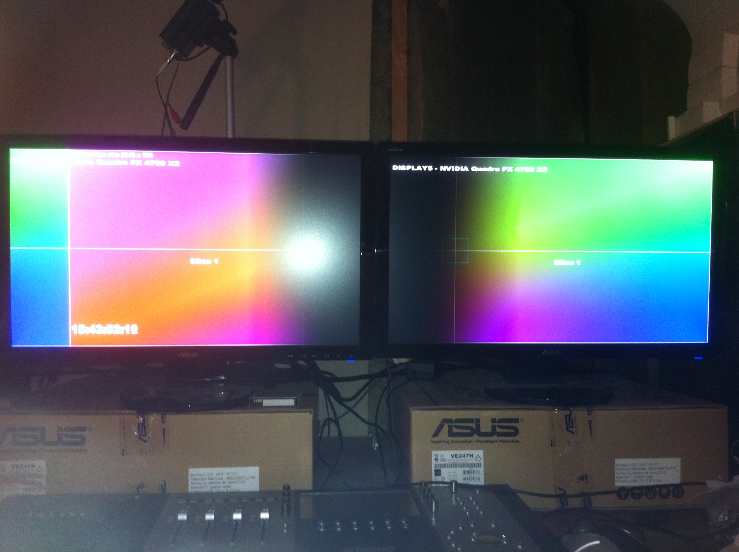

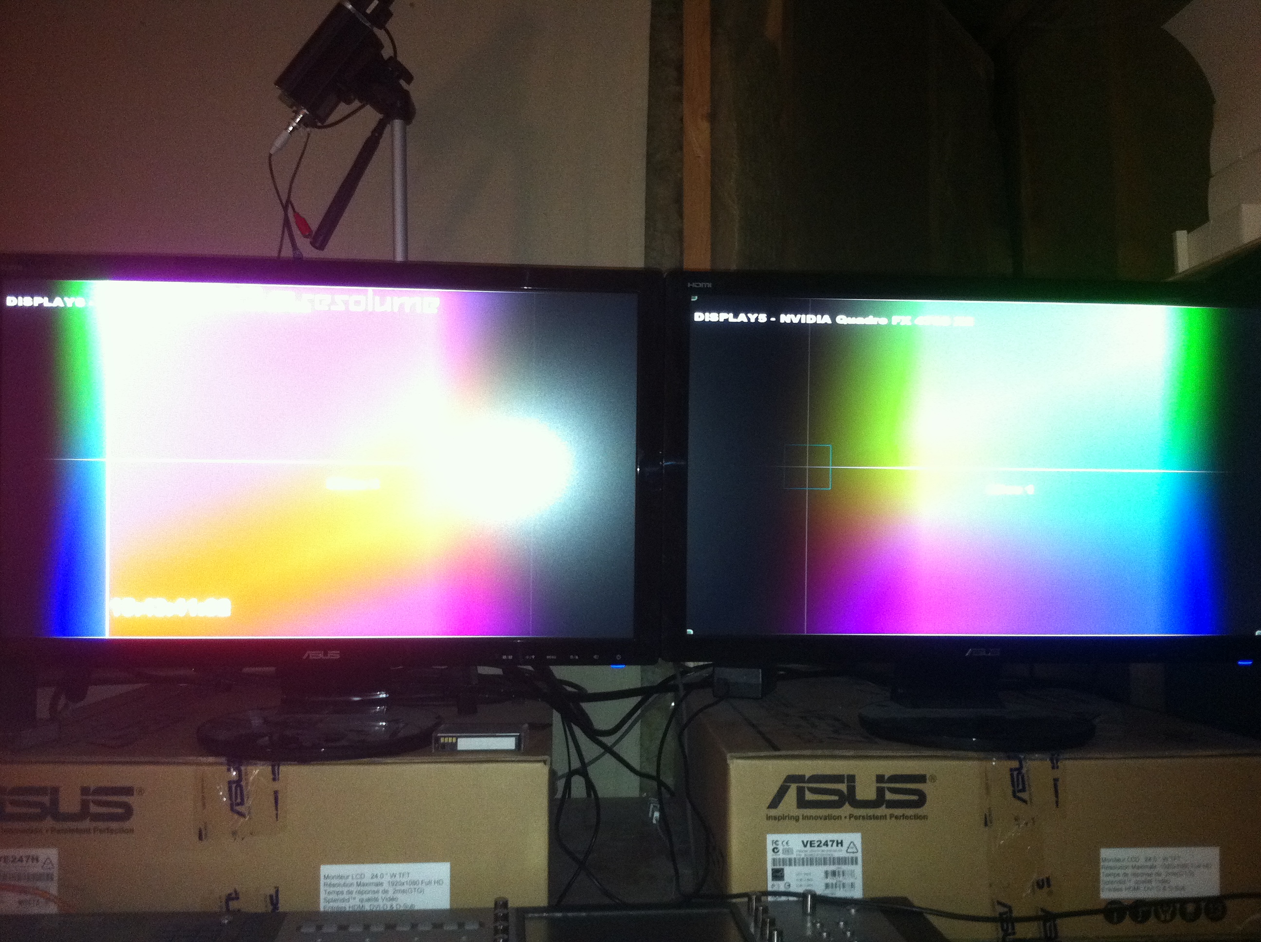

If I only have one slice that overlaps the edge with wrap enabled then both I do get the proper edge blending on the outside edges, until I click okay then I lose the outside blending.
I Can work with this
After OK
After OK

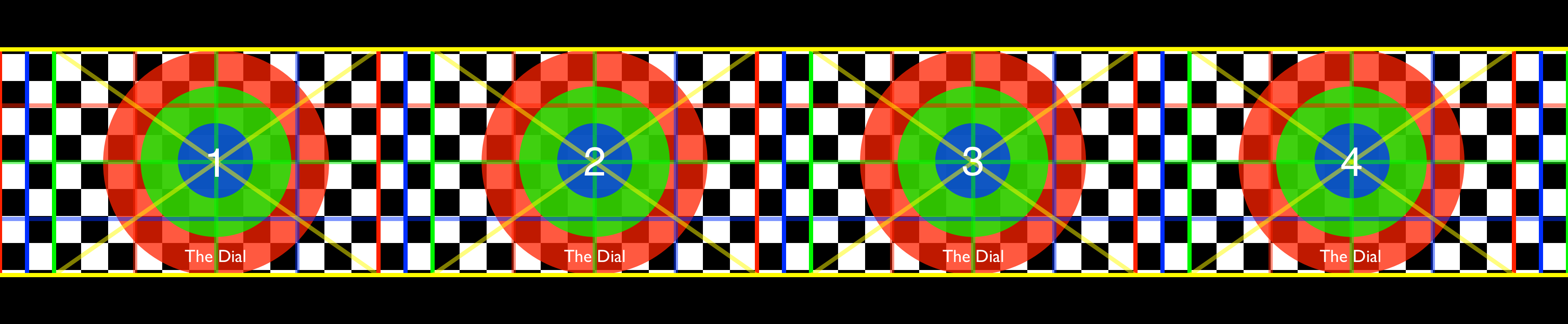

The next question I have on accomplishing 360 degree projection.
In the past in other application I've always had to create my own line up grids to get accurate blends.
In the above example the screen I used had a ratio of 5.74:1 which I used 4 LX1500 projectors with a native resolution of 1024x768. Using a 25% overlap reduced my overall pixel count from 4096x768 to 3072x768. I know it seems like an excessive amount of overlap, but it allows me to create content that can be used in the 360 degree project or reuse the content on a gig that might require a triplehead2go.
I would then created a line grid similar to this one.
Single Screen
Single Screen
Ring Screen 25% Overlap.001.png (81.69 KiB) Viewed 25320 times
Which I sent to each screen to do the alignment, geometric correction, and edge blending.
I'm not sure I understand the method that resolume would employ to accomplish this, the test card that comes with resolume doesn't give me enough information. Using the resolume method of enabling wrap and extending past the composition size to enable the outside blending seems to conflict with the grids I've tested.

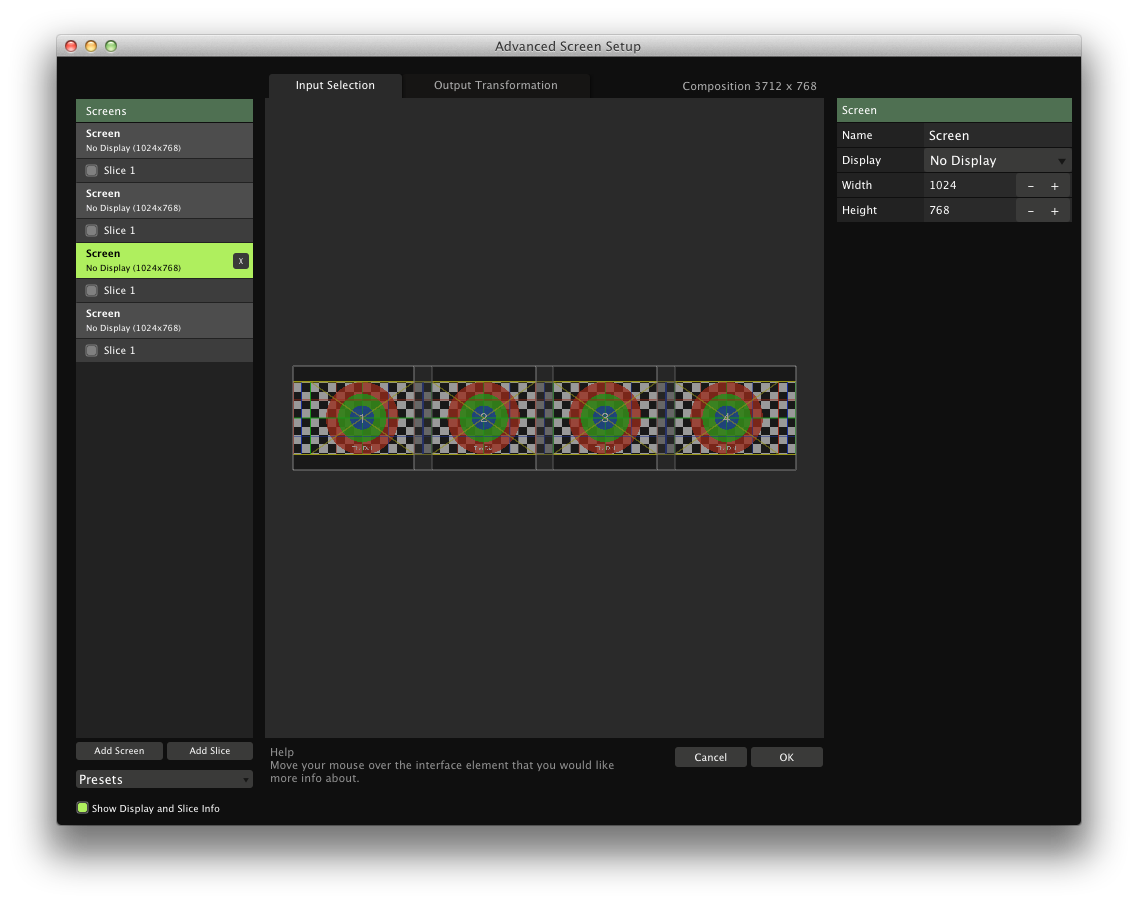

The current grid I've tested with is
Quad Grid
Quad Grid
Ring Screen with 25% Overlap 3712x768.001.png (170.66 KiB) Viewed 25320 times

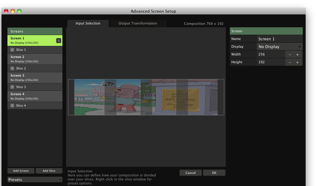

Which is 3712x768 that should allow for 640 lost pixels to overlapping. However I've not yet fond a method of implementing my own custom test patterns on a 360 degree projection. I think the easiest solution would be not to have to enable the wrap and extend past the compositions edges, but simply allow for a soft edge gradient on the out edges. The below image would then result in a composition size of 3712x768, but the blending would out 1024x768 across each output.
Advanced Output
Advanced Output
Screen Shot 2011-10-07 at 8.13.55 PM.png (102.04 KiB) Viewed 25317 times
