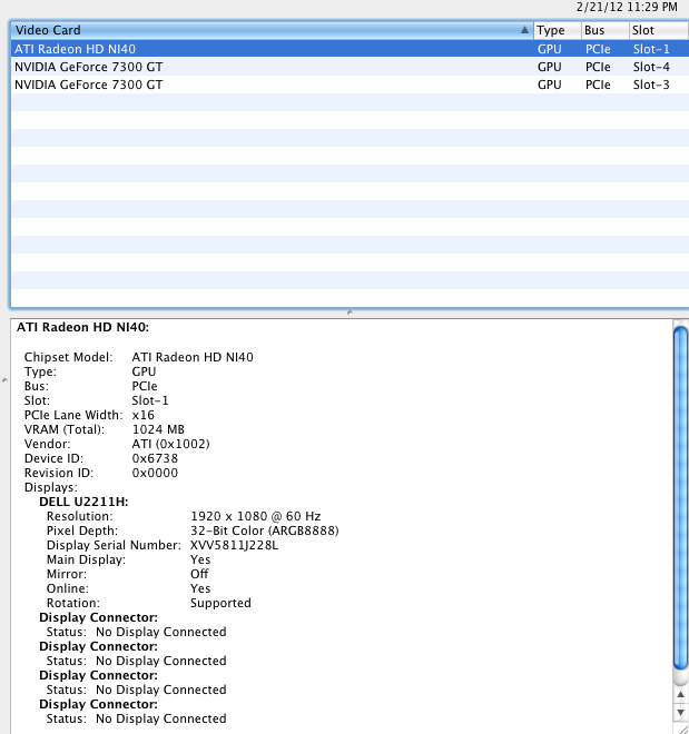

Re: 3 Slow GPUs running 5 Screens
Drats!
The XFX 6870 card works almost perfectly in the Mac Pro. I've heard a few apps crash with this card. Alas Resolume seems to be one of them. Both R3, and R4 crash on startup! So much for that idea. I'll see if that changes with OSX lion. Currently running 10.6.8
Quick Update,
I found a fix for the 6870 crashing in OSX. There is a driver & kext solution found on the groths.org website:
http://www.groths.org/?p=431 Good thing too, since I read lion is no better for driver support, and Mac Pro 1,1 don't work with lion due to the 64bit EFI bootloader needed to run Lion.
Now DVD player and resolume run fine. However the FPS are not as great as I thought.
Only 3 or 4 ports work on the 6870 card with the driver fix. So 2 out of the 4 displays are running the main card via MDP-VGA active adapters for an average of about 14-18fps. a marginal improvement. If only I could run all 5 monitors on the same card. Too bad I have to convert the signal to VGA. I'm going to see if I can get 4 out of the 5 monitors running on the same car and see if that helps.
I'm gong to see how the setup runs on Windows 7 to see if I can get some better performance.
