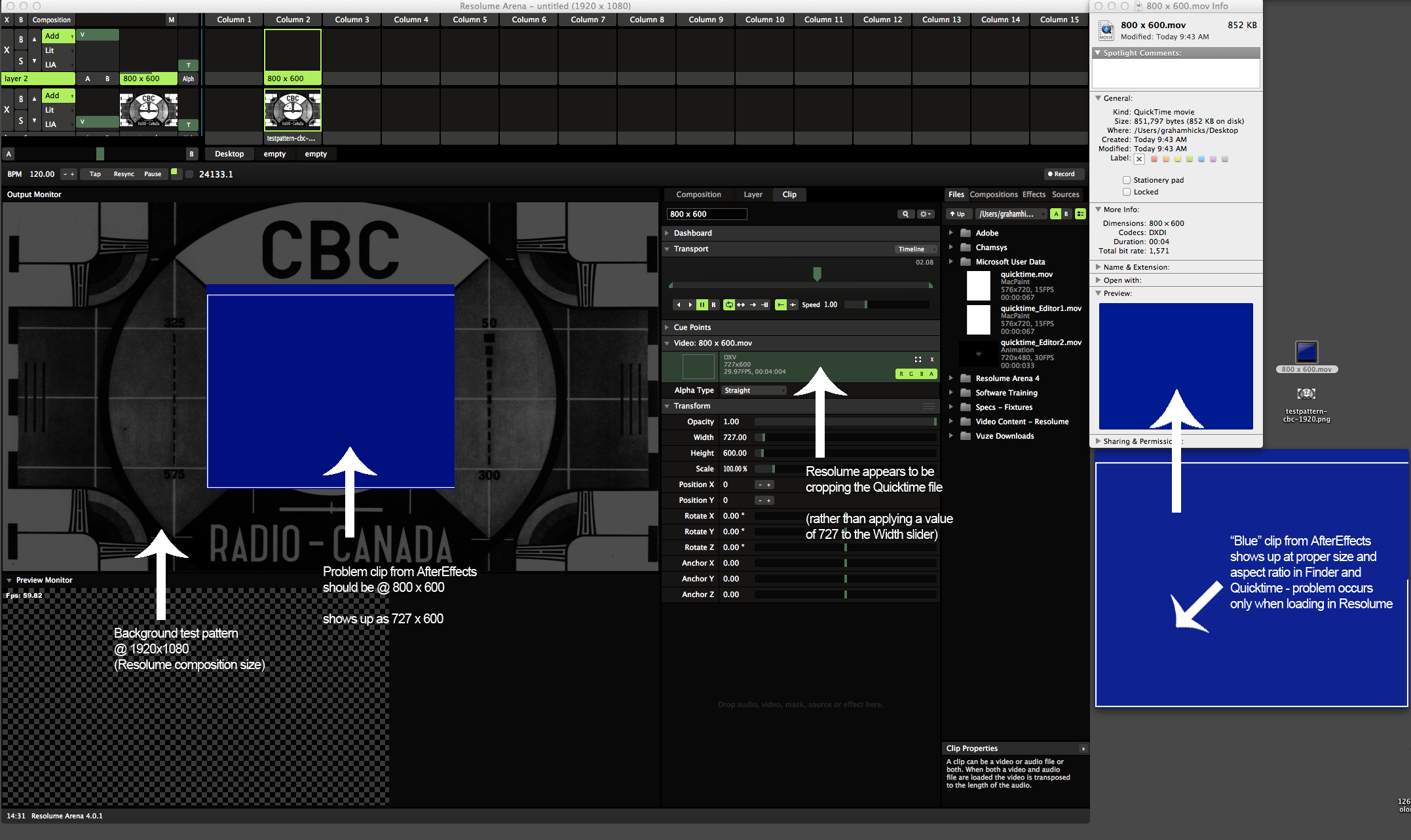

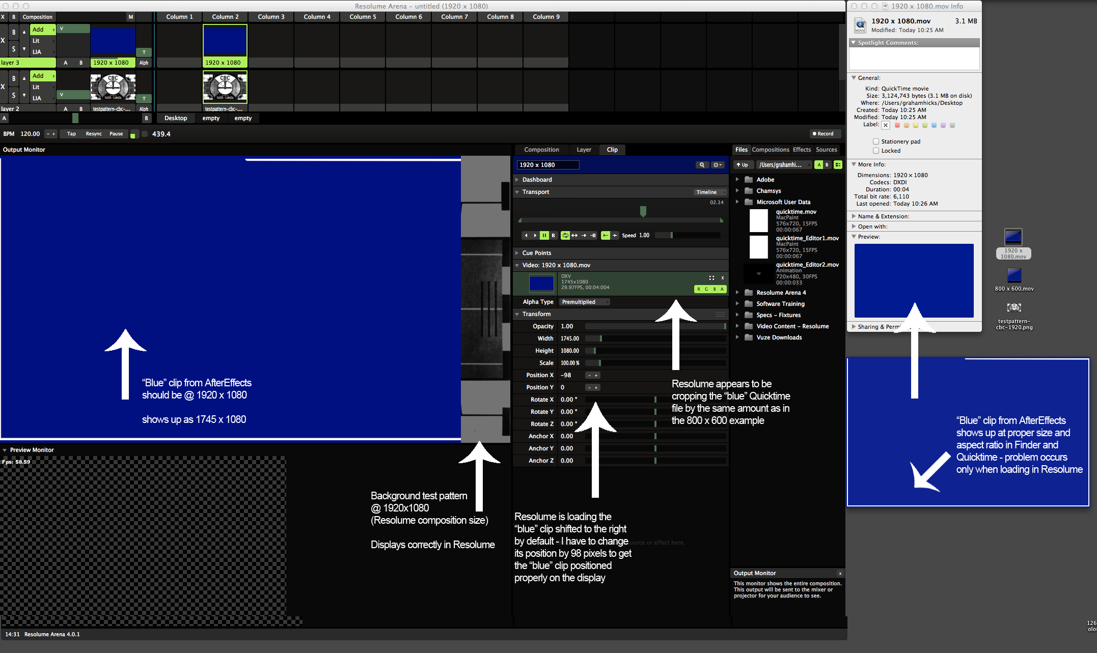

It looks like it's cropping the Quicktime file - see three screenshots attached.
In the two Resolume screenshots, you can see that the file is showing up at proper resolution in Finder and in the Quicktime video player, but when I load it into Resolume, it's cutting 9% of the pixels off the left side of the clip.
The third screenshot is my AfterEffects output settings.
This problem only occurs in Resolume (all other video players show the clip properly) and only occurs with content I have created in AfterEffects (Resolume displays image files and content from other sources correctly).
It appears to crop by the same percentage on any resolution (about 9%) and only off the right side of the clip, never from the right, top or bottom.
Clearly Resolume doesn't like the video I'm making!
Thanks for your help!
