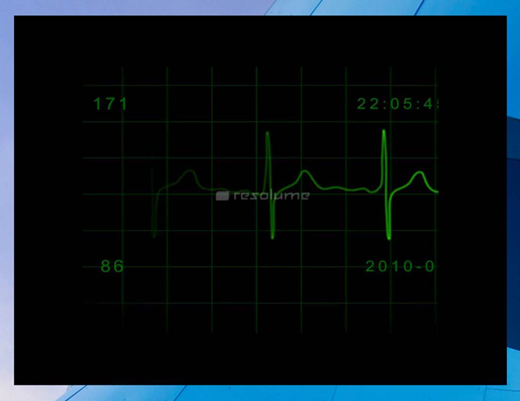

there isn't much really to see. Just what ever video I put in its cutting off the very right hand size of the image. Those numbers in the image carry on further. It keeping the video at the same resolution but its stretching it off the right hand side. I am going to try it on my mac to see if I can just use that. Currently using it on a windows 7 machine.

I now think its the custom export I have done on the video. Its giving me the same issue now on my mac. I will try a different export settings
Re: Video cropping
Just to be on the safe side: Same problem when you play the clip in QuickTime or VLC?
Re: Video cropping
Its only in arena where it crops the video. Fine in quick time or VLC. I have sorted the problem now with different export settings. Now exporting in full HD with my custom resolution central and then I just scale it in the software.
