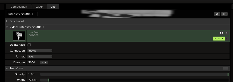

Re: Black Magic Intensity Shuttle, omg plz help.
Have you set the Shuttle to look at the correct input in Resolume?

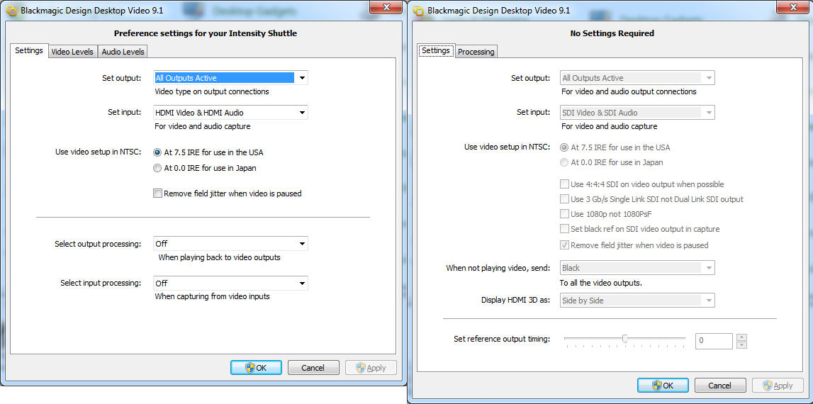

thanks for the quick reply,
Are you talking about the 'when not playing video, send:' setting ???, I can see this setting in the bmd control panel all greyed out when the shuttle is not plugged in.
unfortunately i am unable to find any not able to change this setting and when i do plug the shuttle in the control panel changes its options of settings and i cannot for the life of me find a setting that can point the shuttle at resolume.
what version of the bmd software is recommended ?
or am i still missing something ??
i spent 4 hours last night reinstalling, trying different settings and googling my tits off to no avail ....PLZ HELP.
i took a pic of my bmd control panel with the shuttle plugged in and without the shuttle plugged in and have attatched below.
bmd control panel
bmd control panel
bmd control panel.png (100.77 KiB) Viewed 9947 times
I'm sorry, I mean in the settings of the Shuttle when it's loaded in Resolume.
Post by Borris_yeltzun »
haha, no worries man, the settings for my shuttle inside of resolume were totally different from the the settings you have in your picture.
i reinstalled arena, found the settings and voila it's working !!!!it's working !!!! soooooooo freeekin happy right now. :D
