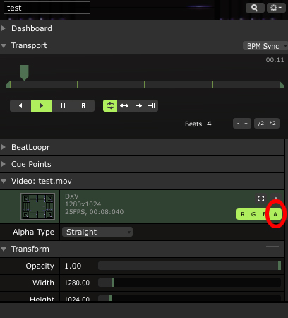

Can you explain what you mean by 'When I activate alpha on the clip,'? If you're changing to the alpha blend mode, you will need to fade the layer up to have the same brightness as on the add blend mode.
GuruMeditation
- Posts: 53
- Joined: Tue Dec 04, 2007 17:13
Re: Arena - bad alpha
So are you turning that button on or off?
When it's lit (the default state for a clip with alpha), that means you have alpha enabled. When you click it, you turn the alpha off.
Maybe you could send some screenshots of both states, with the rest of the interface visible as well?

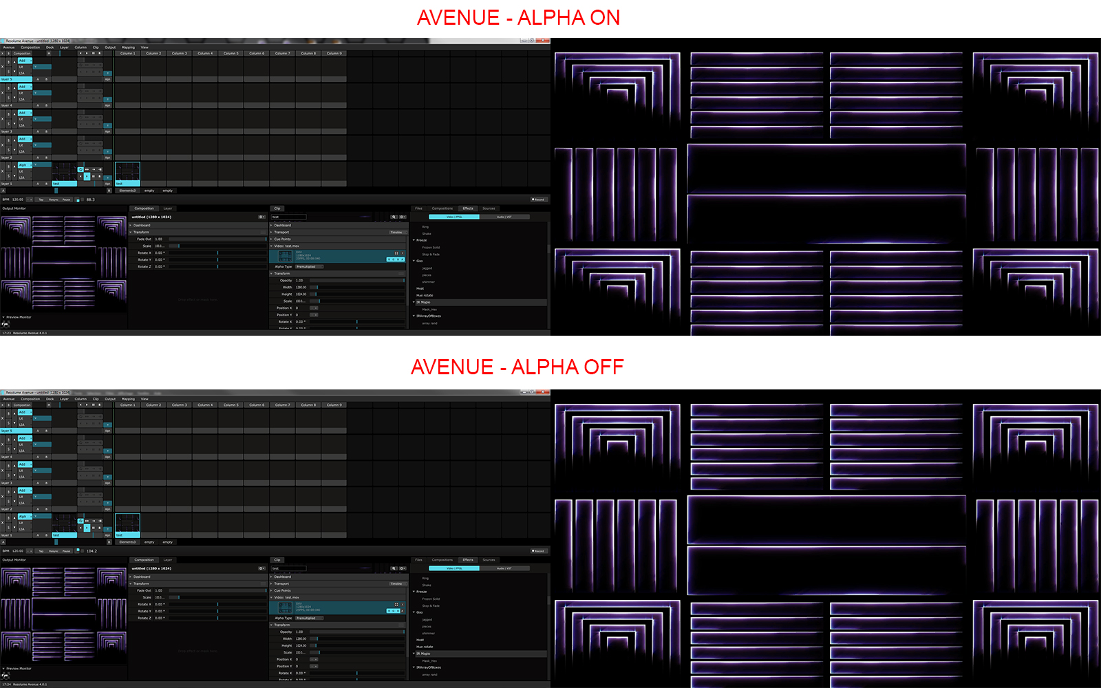

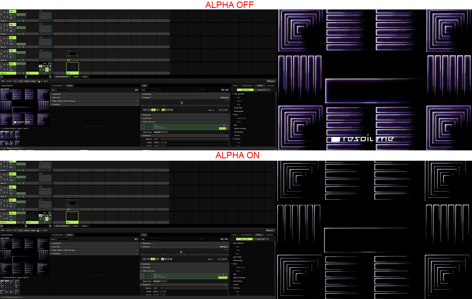

See attachement :
firts pic is Avenue, the other is Arena
Same composition settings, same clip (DXV with alpha, 1280*1024)
No problem with Avenue.
Shitty image with Arena.
I tought it was a problem due to the videomapping module of arena, but even with the basics settings the problem occurs.

- avenue.jpg (642.81 KiB) Viewed 11365 times
- arena.jpg (551.56 KiB) Viewed 11365 times
