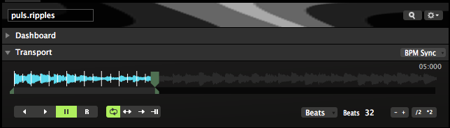

When I reconnect a/v-clips* the duration (in and out points at the timeline) are set to 5 seconds instead of the whole length. (e.g. in-point = 0.00, out-point = 5.00).
Screen Shot 2012-09-15 at 10.03.44 AM.png (22.95 KiB) Viewed 6580 times

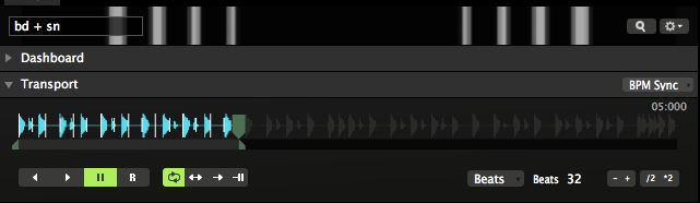

the same happens to effectclips with audio
Screen Shot 2012-09-15 at 10.02.06 AM.png (28.53 KiB) Viewed 6580 times
Note: It seems that this only happens if the clips are set to play the full range. I have one clip which plays just a section, and it is reconnected properly.
* clips are a/v and are composed of one video and one audio file, set to 'BPM Sync' transport and '32 Beats' playback.; Audios are according to QuickTime 'Linear PCM, 16 bit big-endian signed integer, 2 channels, 44100 Hz' in aiff containers; 2 videos: one is h264 25fps 1920x1080 and the other DV-PAL 25fps 720x576) both in mov container. (I can try with DXV, if you think that the codec is related to the issue. Edit: tried with DXV, same thing)

Hmmm, yes we just found out this ourselves as well. We are looking at it, will be a fix for this in 4.1.2.
