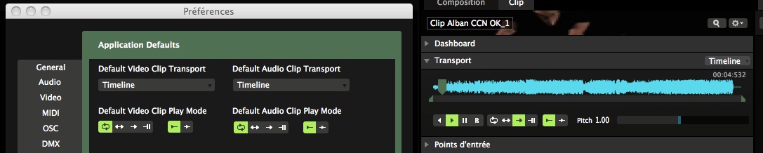

Great idea this feature !
But for me, it doesn't work : defaut settings are "timeline" for audio and video.
But if i choose "play the clip and stop at the end (the little arrow), the clip plays again....
See the screenshoot for my settings :
capture ecran.jpg (62.47 KiB) Viewed 10472 times
OS : Snow Lepoard (MacBook Pro) / Arena 4.1.2
Re: Application default problem
This option is for setting the default behaviour when first importing a clip. So if you set it to 'play once and eject', all clips imported *after that* will be set to 'play once and eject'.
Note that you can still change the setting for individual clips, this has no effect on the default behaviour setting.
If this is not working for you, could you please describe your steps in greater detail? The way I interpret your screenshots and description, things are working as expected.
