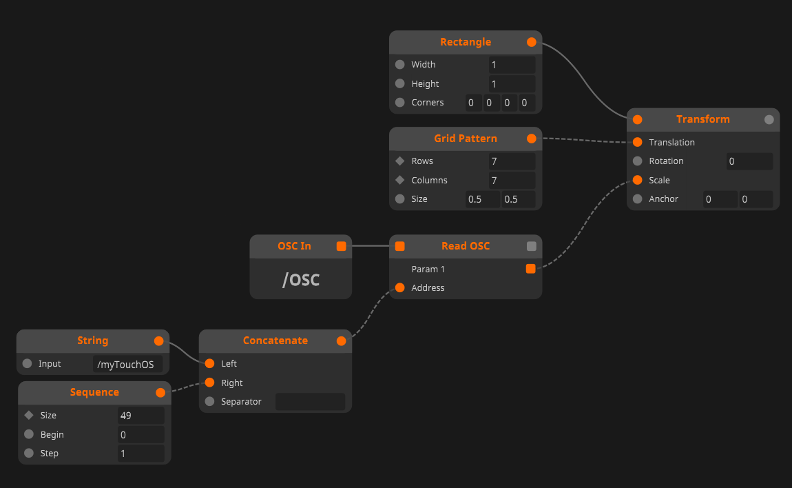

I'm trying to build a 7x7 grid of rectangle shape. I want to be able to control the opacity of each individual rectangle via a button in Touch OSC. Is there a way to somehow iterate through the digfferent OSC adresses and map the valuesto the individual shapes in a grid pattern.

Something like this might work:

wow that was quick! thank you very much! that was exactly what i was lokking for.
