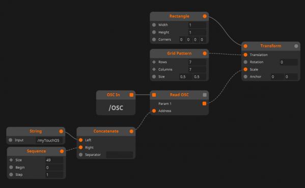

I'm trying to build a 7x7 grid of rectangle shape. I want to be able to control the opacity of each individual rectangle via a button in Touch OSC. Is there a way to somehow iterate through the digfferent OSC adresses and map the valuesto the individual shapes in a grid pattern.

Something like this might work:
--begin-wire-patch--
1614.3oc6Yk0aaaDD9uR.eljcu3d32bjsKxKIEMAn.sUnfhbk71RQpvC63X3+6c1k5fTThRINon.w9flZ8rytyLey0tO5kTjmqSpME4UdW7GO5MurXI7Bx2qnodUSs2Teu5BXDhumI2MvS9aIC66sJttVWl2kt5x37prXKS6QMc.SYvHUI8HRLjk70KMtGgQa3FZ.gndDxGRHrtwook5ppdTxrqcY7RMr73tRTURblFHc55E3cko5RuKdzaQYQyJPy83S9dkEE0sJw7hTs2Ezm.d6ALK1RYbS8sEvb7778Rhq0KJJev6h7lrLeuT8prhGVpyq+Pb4Bcsk9YfRL41V5ygsD71uYJ0vmtSWVYUs.QKi+aKOAc1RSt8MBwo9rSD8zSVNWkTZV4LENVkZpVkE+vaa4HLfIEVVybiUd7vzX4LjFEfmq3Arjzj.EYFJPjfmSimyjBVBLmLShNuReiIaMSVOvNttL1j09VQoYgION6anjQsR1GahyL0fJjRjQfIFLlEYM0qm9sZyhagUCij.T9dSZMLOrhffYVEem9a8to91lkyx2JzMkqe4NcdZqUGHJW+o52BPi2j5cgx2gRrPGOjCeTWWZl0T2NjIupF1Wsen9gU1skIGPMfYB3ZbVCLB1txyJZxSq5Ky7NhL3l7IuK3RQHmh.E.CivQbBLrU2IPgBphSXHBkQEQ.CSxhqZ2Cv1zSH3JAgGEvRmAHhHAMPFGKBXDJmLKgwTTbWcEwwghj+Al6c.1pvB2Kxb5f4vW7XDxMjS.q6sw2JoyyJhq6JmVmKPL2mD1NZfHVtustbqk8iyNflaMo.vGlWGU8zsHfeEBIFmuHyBC1ZZ+q6LUlYVHecYiF3AdncCD0lk4iZ0DvLgcz882f2ui.uJyBvgwhXVGILnktsz69yN5cxGwyokt+Dq8yEwvTjSfXnTBwgX3T5UALZDK30WekLPPmb00WinTwDQWDC8q.wTY9rdeCLoKXHLxG9cZeKcOs4ZivNa9OWZRe0urN0yXlcxPytMDRQ4YalNWyuKWyI35pxhDcZS4lYbFwMXJGTo1kg9b1zVN6RAdtD2oBfyTobXbIEM.WpjpChK4pPbDlyvRHHEhhIiDKSQHP.MDREnthbUPzMRk7ZEaxDJ84FKqEILF1zFoZp+KOG84zMn+NZxNH8cZSWAT+f8XZG22imlaSFwueeOcSXgw1DgXT6WXlBgwbLw+HionbALFiifrKbUj+WvbeYrWF6kw9uYro8Sv+Rttmctt85GYaQeGnPp8KbqWgY98JD0eSgkGpCmOXY77hxkiVpKcXotiW6pFZ3s9rKD8HMvJI6p5yVAHT0WDREJDRASDEIiTPeGtp9fBAOdUdblTEvds35fKQDVvkQnKw2vlvDWy5VkG9qnJu8KMwdHVakJaJ5i0h4ftNd26m7p2Ld+FruxiGvUl+1yyJHG3utbbyQW5sTgOYs9mz.tscRdnhEwAaHFcd1OlbBCpRGdboHhGHwWwEX7jqXBxytJ80G92NoqBTu4K5D5x6O+I3S+X8vFY2BkOBv9Gzhs26LD1yeZnKi+QNRo3zWAd6i5pGMzUOUmXVFmUch9nsa0u3iV.cBlt1o37CmaSXYV965xB84sgOX3iH4fvGDLMjFEIXTFRRbs26BfHhPgLtfx3XElAMNLRW+PhCR.iEwBjJMjd.GSXI5XRZD54FOY8sNb7vIf20xG9PQSxs.D3x1nOfC2Ax7i1j7tugenlczz6uey5ebrF+KM29.vSpYoNup8piFGUzd8Mm4Db4s16D9FPD4nmjYHhyIJrDo1gT1CMAffPtBSwrVnAuCZhzld5DvHJ8xW2BitIhXwQCfQ3uKvnsZe7n4tf2++0OtiJPaiTV26zwNf.1ykXMDzgFNDt6PPqcdASJxsW0VN76ntBhgtByzKLm5rK2.J+lef9cX7o7CZcVp0qNWV9LbaHXKUTBPGEpkaaPXINJThkpsNSiTS2LUbPrXN2dFrZImKilySdtgecFqwzRn0JoS1LxNjWG.PWEr+ItEg2q+XiFBFOBdCVlFi6xhfoT5tbXP4FPjgRAkhoJDUh5zjSffER3v+PHwBpjHc58OWXuxZTHj1KhPXHEClnDhp47zxZuSeqfXORaaCObO6MVYu9BKf2Vqgum8hxe5eAOp1TX
--end-wire-patch--
--end-wire-patch--

wow that was quick! thank you very much! that was exactly what i was lokking for.
