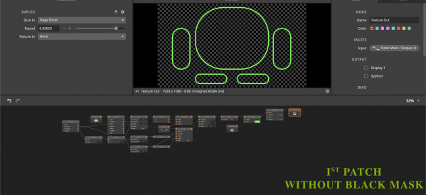

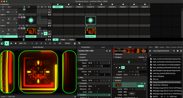

Hello Firends . I create a patch with the help of members. I create the round corner with Blackmasking .The patch is running well as showing in image 1. The Problem is that when i execute into the Arena and run video below it the the video is showing behind the black mask about 1-2 pixels .
how to fits the mask properly. I am Sending the code

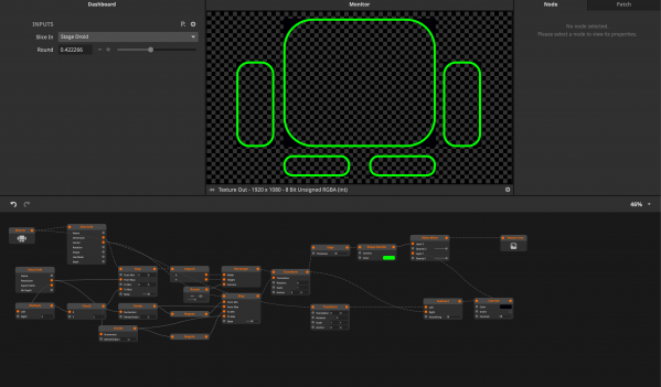

Have a look at the patch I included, it's yours and you were almost there. You just had to use a mask.

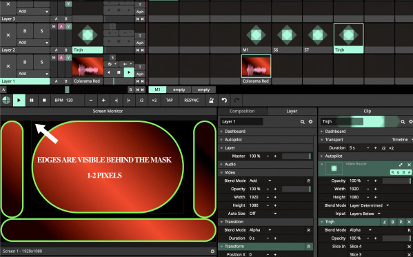

Thanks @tijnisfijn.In the First patch there is no Black masking . it means when i run in Arena . the video under edges are visbile.[1st image]

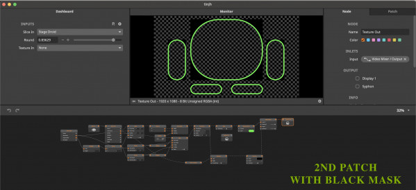

In the second Patch i created a Black mask behind the edges. it works well.[2nd Image]

Problem is that when execute the 2nd patch in arena . there is little empty pixel occur in edge boundary and the visual playing behind it visible [3rd Image]
i want to fill that Pixel

The easiest way is to invert your mask. Don't mask out the corners but mask in the centers.
