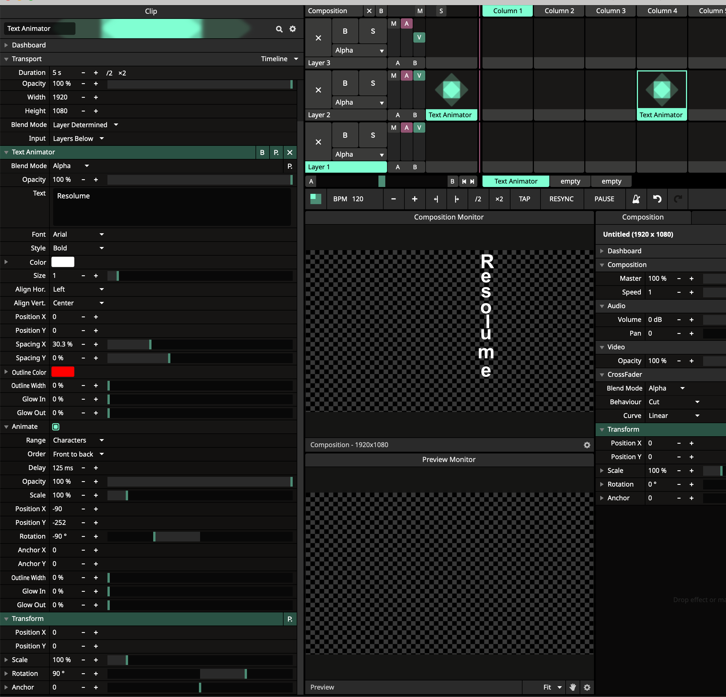

Re: vertical text
@Zoltan , you are such a smart cookie, thanks a lot <3
