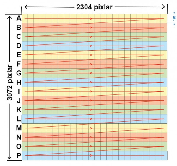

So, the resolution is 192px high and is divided in 16blocks with each 2304px wide that form a C shape around the arena. Not a full ring so there is a start and end of the screen setup. So how you see the screens it´s a 192px by 36864px long screen !
How the arena software reads this exported video file, it´s a 2304px x 3072px video ( 192px x 16panels stacked on top of eachother)
So how do i set this up if i want a seemless graphics between the screens?
As an example, a logo that moves around the arena screens from left to right. When the logo leaves the 2304 wide canvas it needs to show up in left side row B etc.
Attached the image how the film should be exported i hope that helps.

Sounds like a making content question. In after effects or whatever I’d make a full width clip that you make the content in, then chop it up in another comp to fit the mapping.
Led processor looks at the same and you have seamless mapping. Not sure any codecs would support a 16x2304px. If they could chop it up resolumes slicing. But usually you content to suit the layout for things like this.

Exactly, tried that. But the full with resolution is too big for the software: AE, Davinci Resolve and Premiere Pro.
Davinci wont let me go under the 192pxl height.
And if i were to make it half resolution and export in full (if that works)
