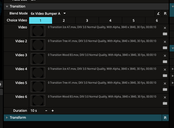

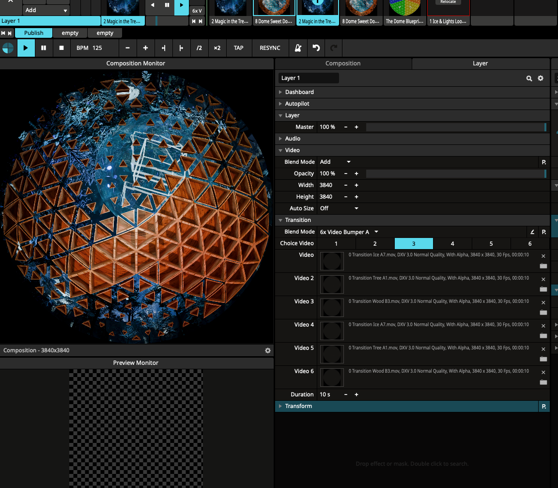

Below I will outline what we are looking to achieve and I would like to understand if every feature is possible, only some, etc. (The original thread details the Minimum Viable Product with a few working examples and good screenshots.) Most of the work is likely already done we just need a few finishing touches.
The Goal:
To easily create a "show" file for visual experiences that are more of a playlist than a live VJ setup. Think very automated and giving the client only a giant play and pause button.
Imagine you have a walk in look, x5 1 minute videos as the show, and then a walk out look.
We can do all of this right now but the stock transitions are simple variants of a cross fade and we want to have a custom clip with an alpha channel with sound go "over" the transition between the first and next of the 1 minute videos.
This way the transitions can be very cool, custom, and easy to change out and there are no hard cuts in between or simple cross fades.

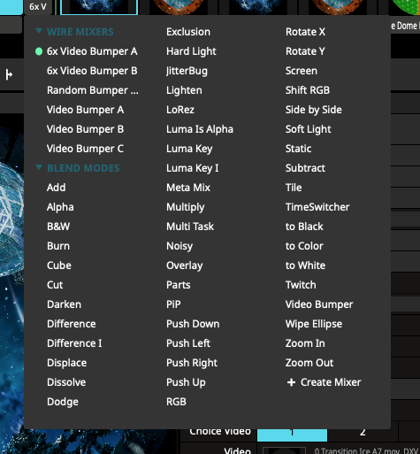

As some may already be aware the user can only choose x1 transition type per layer at a time so we want to pack the optionality of using a different alpha transition clip into one Wire Patch so it can be the same Transition type each time but a different actual alpha transition each time. Not sure if that makes complete sense...

• Alpha Transition Video "Over the Top" of the underlying clips
• Transition up to 10 seconds
• Works with any resolution and aspect ratio
• Choose 1 of 6 videos from a local file
• Skip any slots if no video is used/present.
• Option to "Randomize" or "Autopilot" the Alpha Transition clip being used. I.e. only use the #1 video OR advance the next in sequential order after a transition OR choose the next randomly after a transition. Kind of like Autopilot for layers.
• SOUND is enabled in the Alpha Transition. Very important! Can this be done for a transition?
• Settings are saved and ready to use the next time the show is loaded.

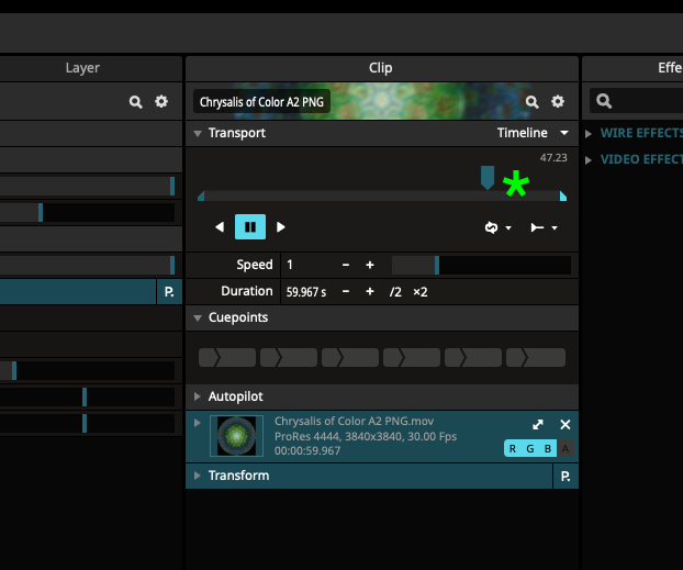

Is there a way to use the playback from one clip to trigger another at a certain time?
Say clip one was the main clip and it is 60 seconds.
Can I set a "cue" or "event" at the 55 second mark that hits play on the 10 second alpha transition with audio?
Then at 5 seconds into the alpha transition the underlying clip one will transition to clip two and in another 5 seconds the alpha transition vanishes and no one is the wiser?
See attached screenshot. Like here at the green asterisk I could have a custom OSC or MIDI message hit that triggered another clip?
I am not seeing a native way to do that but maybe there is with Wire?
Or, maybe there is altogether an even different way to achieve this?

Posts: 7800
Re: Wire Developers for Resolume Avenue / Arena for hire?
Autopilot should be able to do this
https://resolume.com/support/en/autopilot
