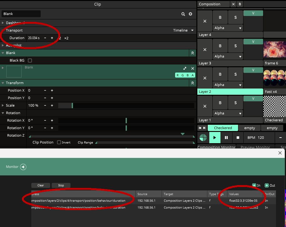

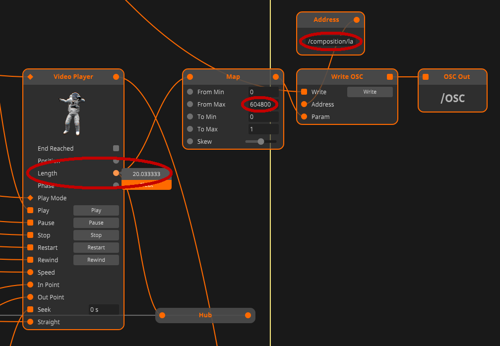

I tried sending the Video Player's Duration value to Resolume via OSC, using the OSC address for the clip duration. Original value not translated exactly, likely due to limit of precision of the normalised float.

Not shown: Video In > On Change > Write OSC : Write
The OSC message received by Resolume, address matches shortcut address for the (specific) clip's duration and converted back from the normalised float (range 0 to 1) back into seconds.
Original value: 20.033333 s
Resolume interpreted as: 20.03433 s
Discrepancy: approx 1 ms
The scaling factor is a week of seconds:
7 days x 24 hours/day x 60 minutes/hour x 60 seconds/minute = 604800 seconds
It seems to work, however the specific clip's OSC address must be supplied. It could be a parameter to your Wire source/effect/mixer. Not especially elegant, but functional.
