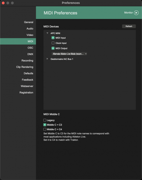

Hi Zoltan,
Here are the screenshots.
I don't know, if you need more but I will try to explain what's happened.
Everything worked perfectly until v7.24.0.
Then I've seen that some leds don't react until I press the button. And when I change deck and go back, the problems happen again. I've tried different cables, started a new fresh midi preset but It didn't change anything. So I decided to go back to v7.23.2 and the problem was solved.
Thank you
