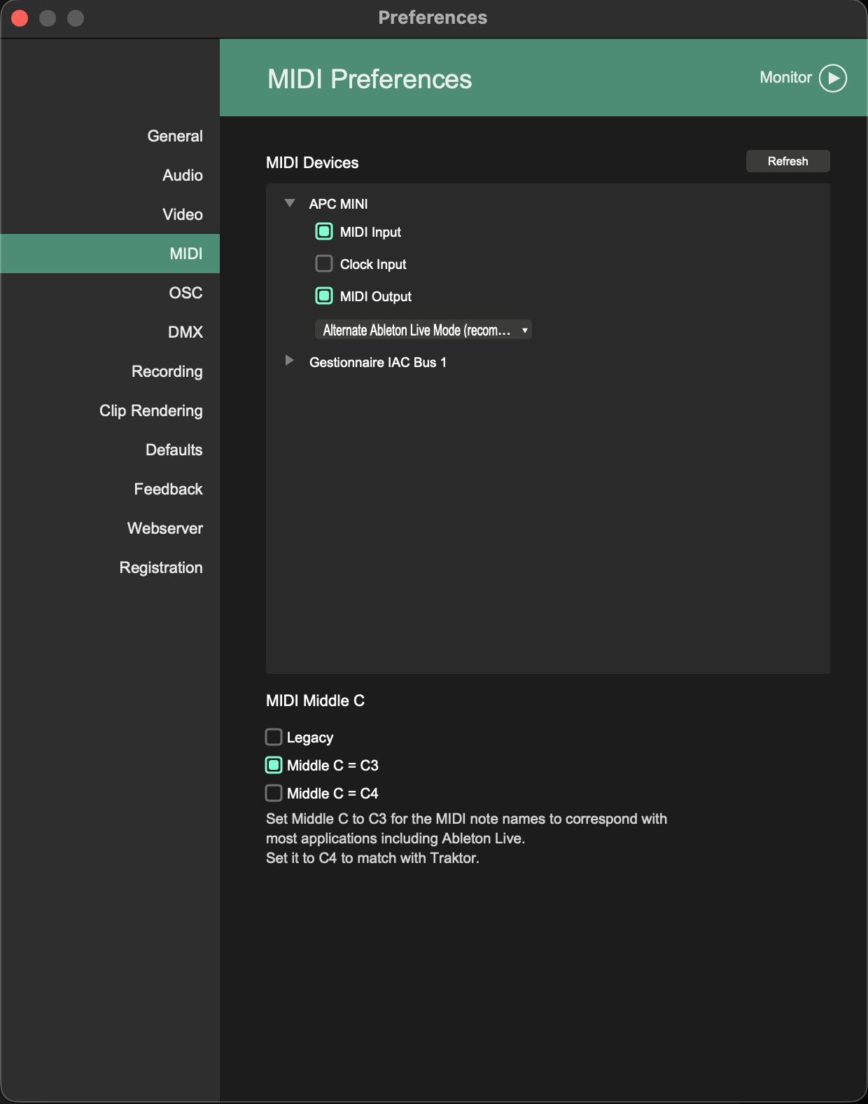

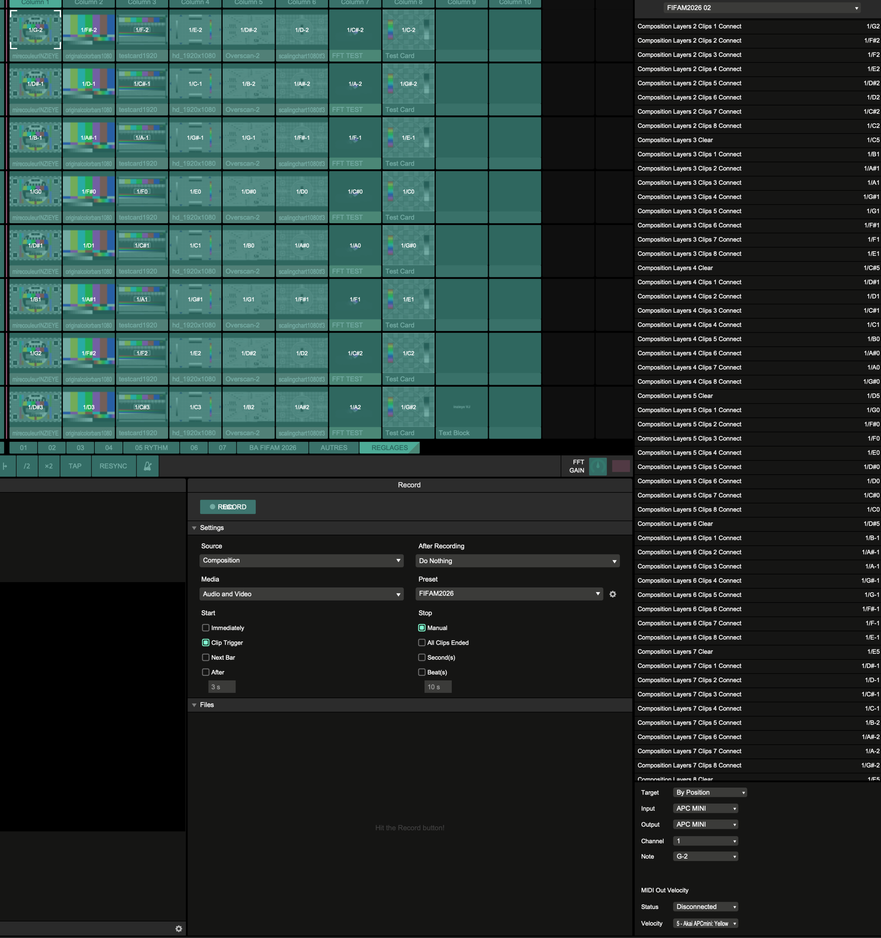

can you share some screenshots, of the midi preferences, and the shortcut setup?
Re: Led Feedback bug
Hi Zoltan,
Here are the screenshots.
I don't know, if you need more but I will try to explain what's happened.
Everything worked perfectly until v7.24.0.
Then I've seen that some leds don't react until I press the button. And when I change deck and go back, the problems happen again. I've tried different cables, started a new fresh midi preset but It didn't change anything. So I decided to go back to v7.23.2 and the problem was solved.

Thanks, we were able to recreate the issue, and are looking into a fix.

Thanks, sounds like the same issue about shortcut handling.
