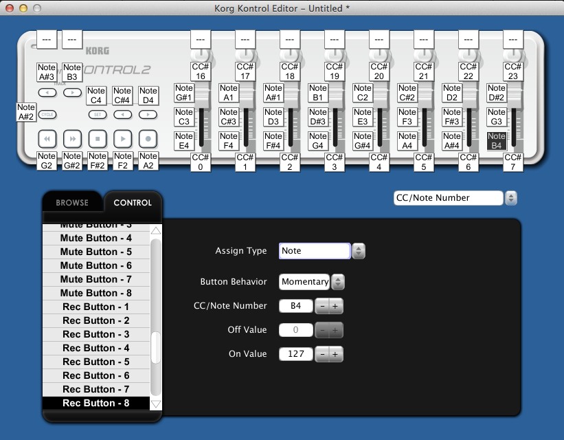

This is because by default, the Korg Nano buttons send out CCs instead of Notes ( which is pretty silly if you ask me ).
Use the Korg Editor app to change all the buttons from Controller Change to Note and you'll be fine. I'm also adding a Scene file that has the correct settings.
NoteSetup.nktrl2_data.zip
(342 Bytes) Downloaded 511 times
