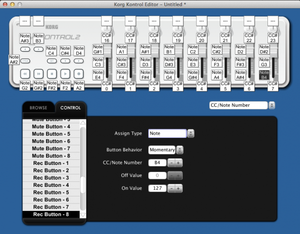

I bought a new one nano kontrol 2 and i have a big bug on it. When i try mapping the S M R they jump. For example: I try in a clip define S to pause, M to play and R to loop in clip. But when i press they go to repeat and return to pause, all of them.
I also wanna put the buttons fixed, like when i press S one time, they fixed on loop and not only since i have it pressed. This is because is toogle or momentary, no? Toggle fixed the function and momentary is only when i press, is right?
I already install the KORG EDITOR and tried several configurations, but seems that nothing change.

This is because by default, the Korg Nano buttons send out CCs instead of Notes ( which is pretty silly if you ask me ).
Use the Korg Editor app to change all the buttons from Controller Change to Note and you'll be fine. I'm also adding a Scene file that has the correct settings.
