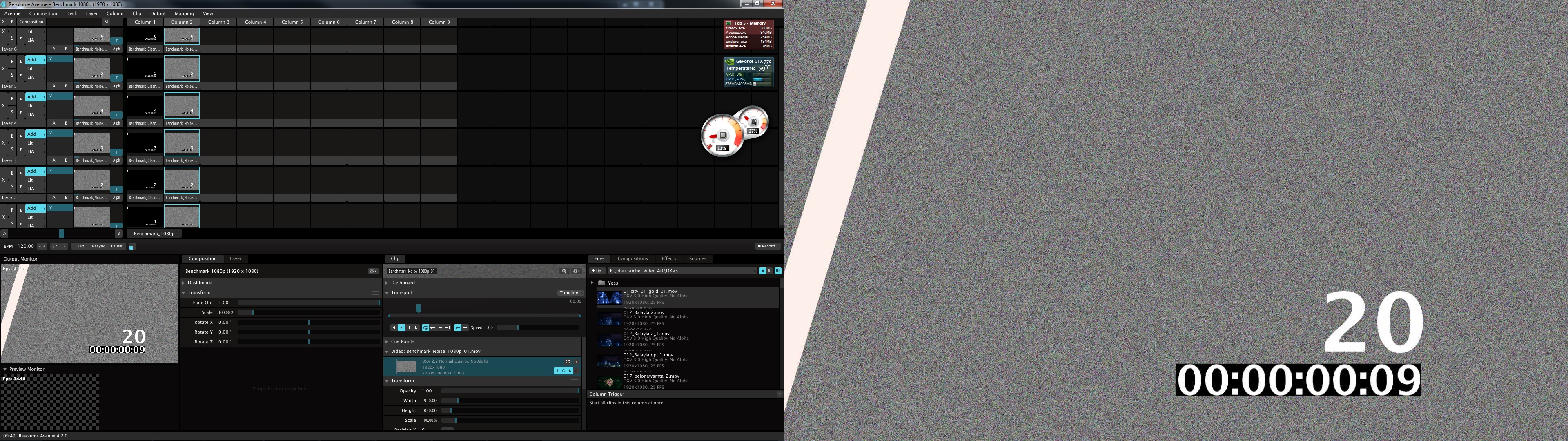

Whatever i do, i cannot make my system to run 100% perfect smooth videos and i do not know why!
my system:
cpu- i7-4930K 3.7Ghz
RAM- 16GB DDR3 Quad Channel
GPU- Geforce GTX770 (Latest drivers)
HDD- Samsung SSD 840
Windows 7
Resolume avenue (latest)
* all files converted to DXV3 high quality no alpha
* nothing in my system is overloading including CPU, GPU, and HDD (see attached image)
* i get 35-40 FPS in the benchmark with all layers on! (see attached image)
So where is my Bottleneck??
and why cant i get a smooth playback?
a
I really like this software but in big productions i look like ameture.
Please help me solve this once for all.
I must solve this stuttering problem once and for all

Hey Steve...now I would like to see your un-smooth playback. Can you capture your output monitor with a camera which is able to record with 50fps?

do you mean what comes out of my gpu card?You've described most of your setup but you haven't included what downstream from your GPU so it's hard to know where the stuttering comes from. What's your complete setup including adapters, processors, length of cables, amps, etc...?
an HDMI cable to a broadcast sony monitor
here it is, an empty composition and stillHey Steve...now I would like to see your un-smooth playback. Can you capture your output monitor with a camera which is able to record with 50fps?
https://drive.google.com/folderview?id= ... sp=sharing

Re: I must solve this stuttering problem once and for all
Hi Steve thanks for the clips...can you upload the original files from the camera you used?
Can you use wetransfer.com or dropbox? The quality is very crappy via google ...and who knows how they reconvert uploaded stuff really!? If your recording was already that crappy....do you have another cam?
+ ...is this the testclip I gave you? or another one?....If it is your own testclip...may I have it too?
+ can you please post a screenshot containing ALL processes of your "processes-tab" from your Windows task-manager while Resolume is running?
