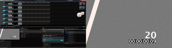

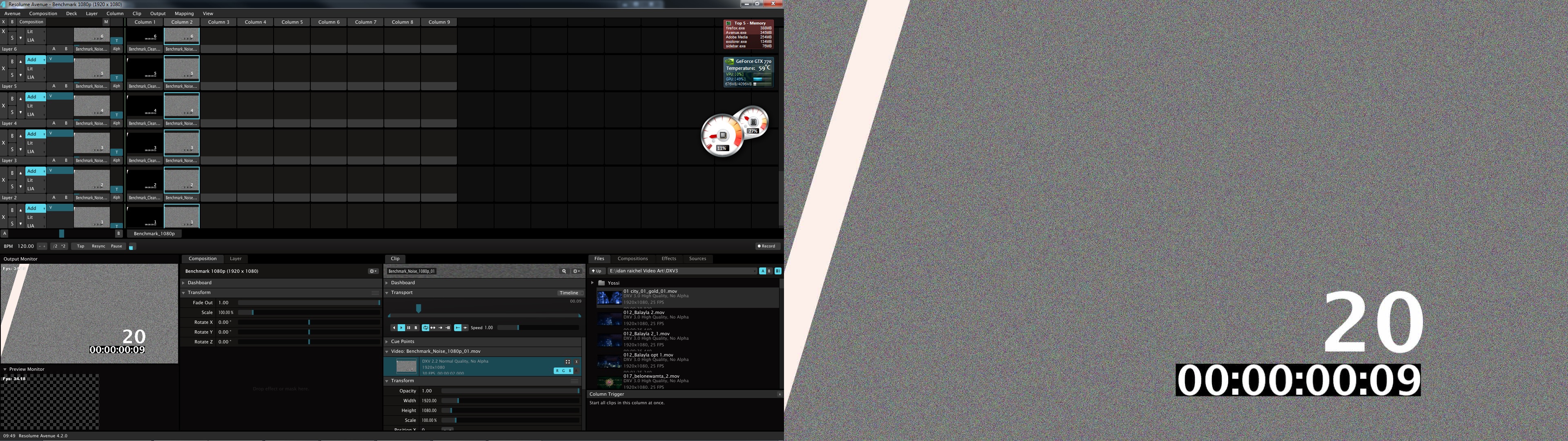

Hey Steve...now I would like to see your un-smooth playback. Can you capture your output monitor with a camera which is able to record with 50fps?
here it is, an empty composition and still
https://drive.google.com/folderview?id= ... sp=sharing

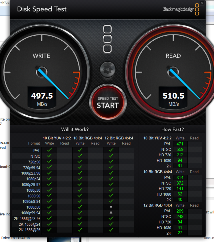

and here are my HDD test results

Hi Steve thanks for the clips...can you upload the original files from the camera you used?
Can you use wetransfer.com or dropbox? The quality is very crappy via google ...and who knows how they reconvert uploaded stuff really!? If your recording was already that crappy....do you have another cam? :)
+ ...is this the testclip I gave you? or another one?....If it is your own testclip...may I have it too?
+ can you please post a screenshot containing ALL processes of your "processes-tab" from your Windows task-manager while Resolume is running?
