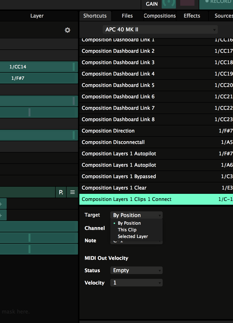

When mapping take a closer look at target, your mapping to selected layer not this layer. Change your mapping target and your effects will work. This caught me too.agentogden wrote:

Edit. For issue three your not choosing a layer as a source by chance are you?

How do you add the effects to the layer?agentogden wrote:ISSUE #2
Adding an effect to a layer effects all the clips on that layer as it should. However, if that layer is not selected the effects do not work. Effects only work if the layer is selected and highlighted.
Please post a screenshot showing your effect and layer, so it's easier to figure out what might be going on!
If you are using MIDI Shortcuts for example then your issue is probably what Drazkers said, but you said nothing about MIDI and switching effects on and off...

BY "how do I add the effects to the layer" do you mean how do I switch the effect on and off or how do apply it to a layer for use?
Hue Rotate added to the Layer FULLBOTTOM. Layer FULLBOTTOM is selected so the effect works fine. The hue rotate attribute in the effect is assigned to a mini shortcut.
What else do you need to see?
I'm not sure where you change the mapping target.

Which one do you have problems with?agentogden wrote:BY "how do I add the effects to the layer" do you mean how do I switch the effect on and off or how do apply it to a layer for use?
It's in the Shortcuts panel, which only shows, when you are in Shortcut mapping,agentogden wrote:I'm not sure where you change the mapping target.
That's the first option, where you probably have "Selected Layer" selected.

Got it. That definitely fixed that one. Thanks.Zoltán wrote:Which one do you have problems with?agentogden wrote:BY "how do I add the effects to the layer" do you mean how do I switch the effect on and off or how do apply it to a layer for use?It's in the Shortcuts panel, which only shows, when you are in Shortcut mapping,agentogden wrote:I'm not sure where you change the mapping target.
