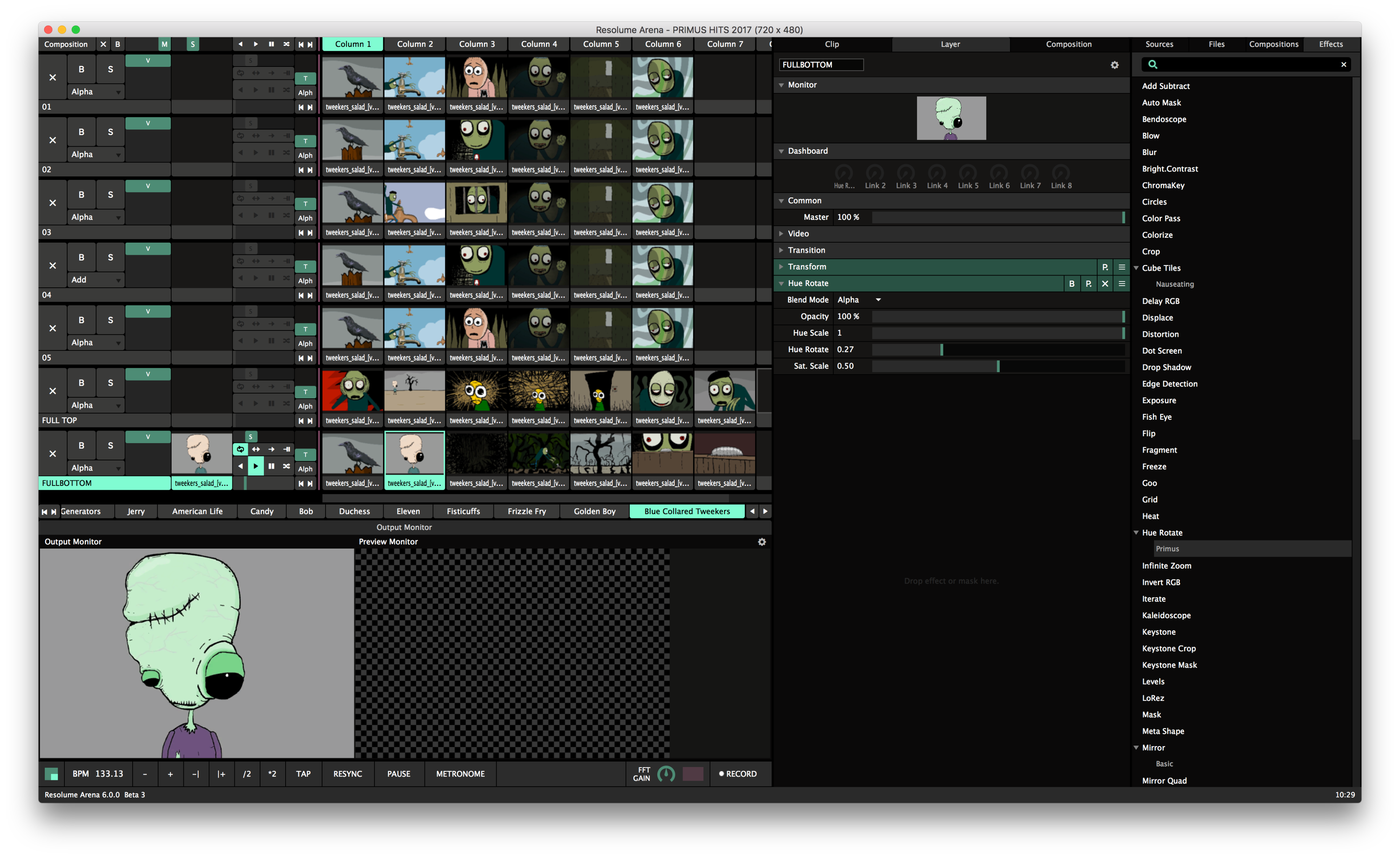

Here is a screen shot.
BY "how do I add the effects to the layer" do you mean how do I switch the effect on and off or how do apply it to a layer for use?
Hue Rotate added to the Layer FULLBOTTOM. Layer FULLBOTTOM is selected so the effect works fine. The hue rotate attribute in the effect is assigned to a mini shortcut.
What else do you need to see?
I'm not sure where you change the mapping target.

agentogden wrote:BY "how do I add the effects to the layer" do you mean how do I switch the effect on and off or how do apply it to a layer for use?
Which one do you have problems with?
agentogden wrote:I'm not sure where you change the mapping target.
It's in the Shortcuts panel, which only shows, when you are in Shortcut mapping,
That's the first option, where you probably have "Selected Layer" selected.
Got it. That definitely fixed that one. Thanks.
