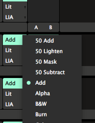

I want use this setting for one layer over the other in advanced output
Schermata 2017-11-14 alle 15.16.43.png (31.55 KiB) Viewed 4222 times
Posts: 7773
Re: Layer like a mask in a advanced output layer
Oh, ok, you are using Resolume 5.
Advanced output doesn't have blend modes, the slices are simply displayed on top of eachother.
Do you need your (layers routed to) slices masked individually with the same video clip at different locations in the output?
