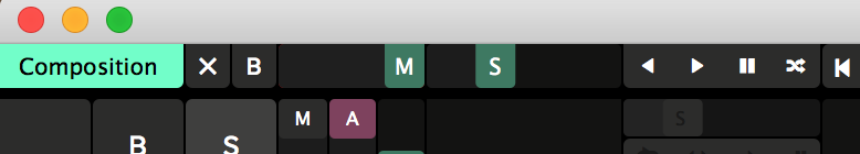

the composition has a speed slider which should do this, it's the one with the 'S'
