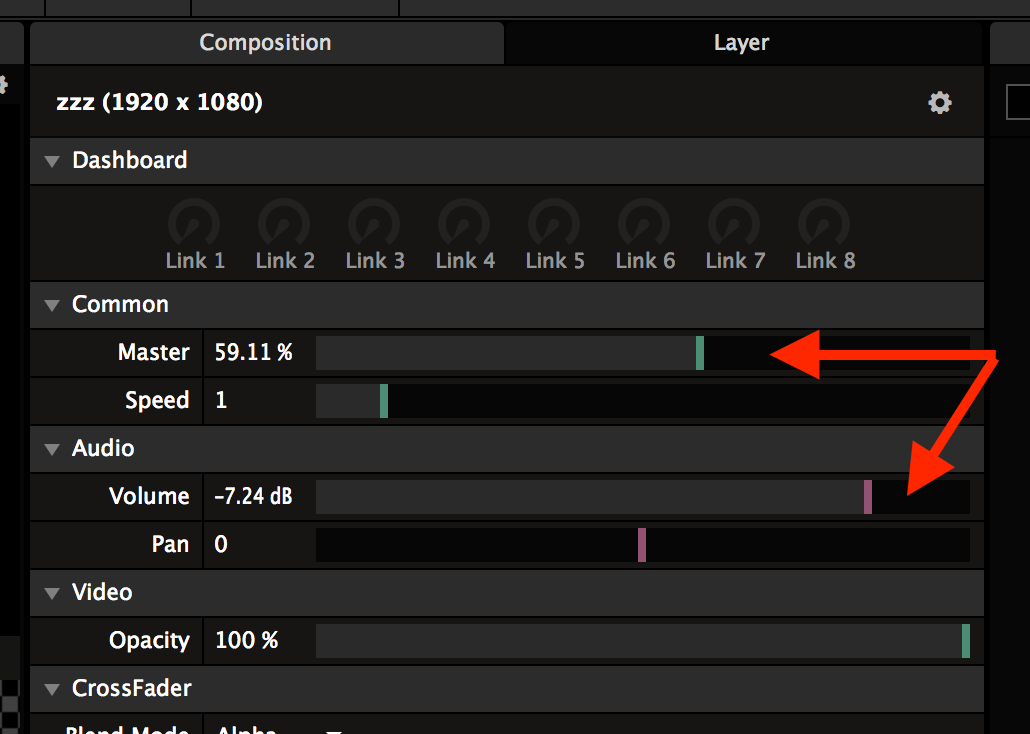

There is a separate audio volume slider in the Composition panel. And there is a Composition master opacity in the UI, which also fades the audio, so if you play your clip in the layer and don't see the output, chances are that it's turned down.
The Layer preview is indeed pre-fader, so you can check what's going on in the layer before fading it in.

Thanks for the explanation! Routing the preview audio pre-fader makes sense... ;-)
The volume fader in the composition panel was set to full volume, so I don't know what the problem wass.
