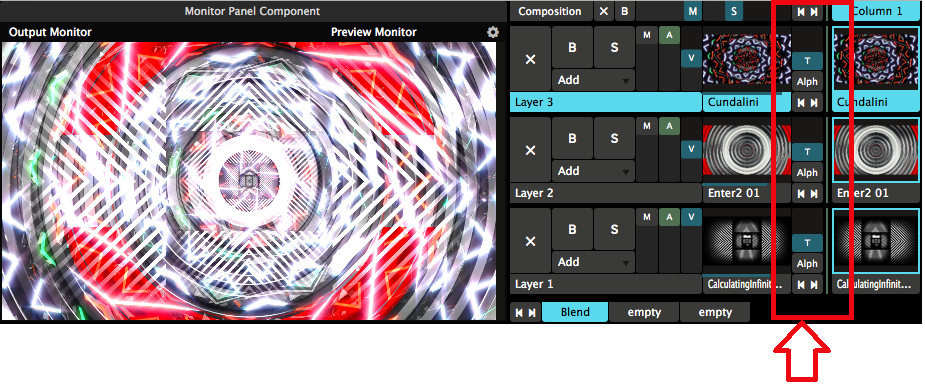

Maybe its hidden... check the "View" Tap at the top and then check "layer transition controlles" ...
you can see multiple screenshots here :
https://resolume.com/support/en/layers#layer-transition
Transition
Transition
~Berlin~

I got it, thanks dear very much
