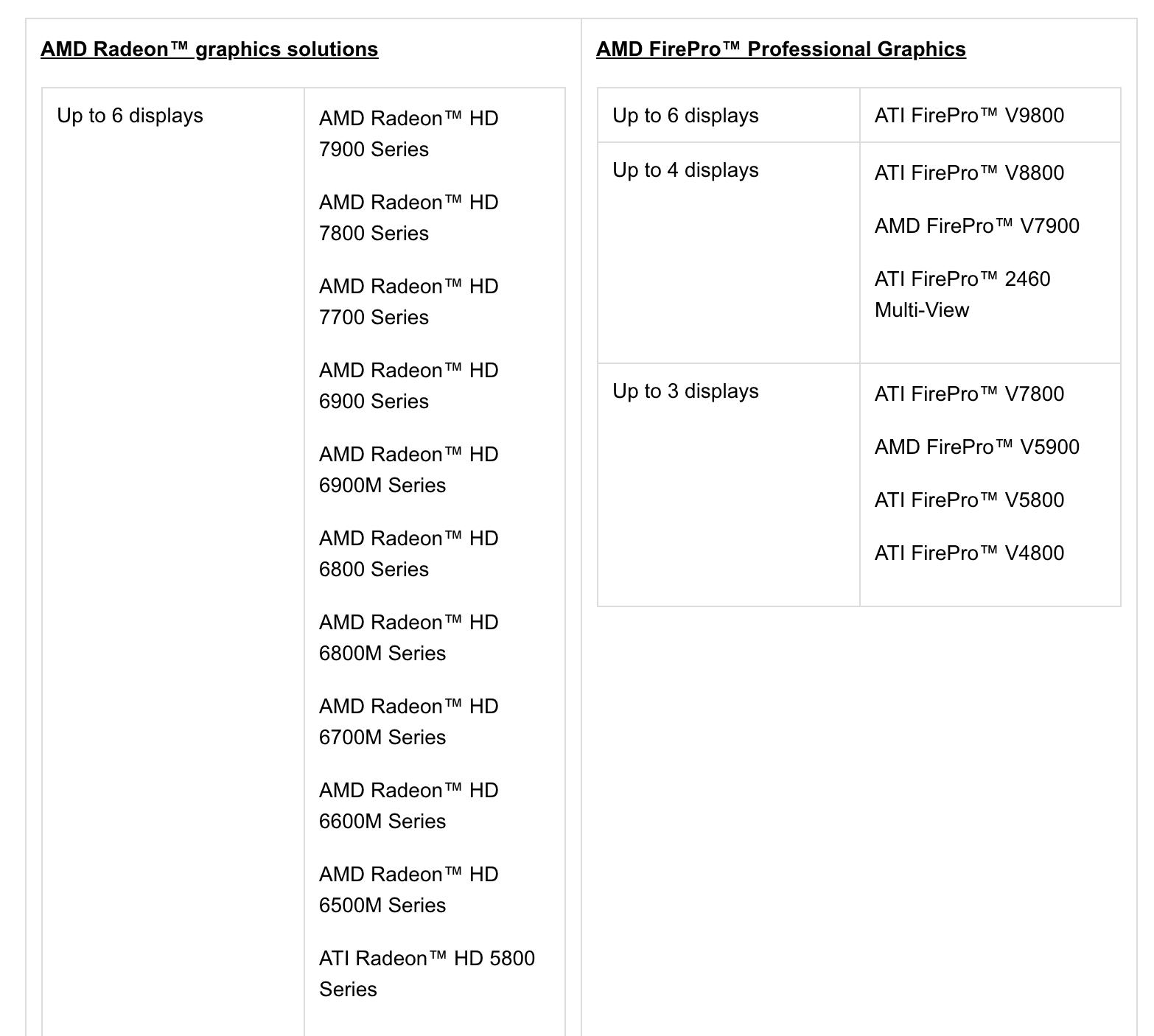

Re: AMD - do you have a specific R9 card that you can recommend? I'm trying to find one that supports MST for 6 outputs and having trouble.
I found this list - anyone use any of these before with resolume + 6 outputs / MST?
https://support.amd.com/en-us/kb-articl ... yFAQs.aspx
