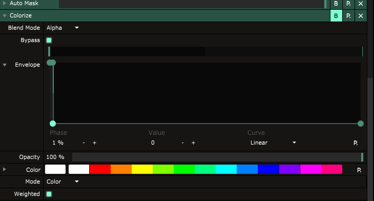

If you're on 7, try Envelopes.EX: Bypass for Hue Rotate On at 0% to 1%, Bypass for Hue Rotate Off above 1% and actual hue value changes happen between 1% and 100%

I'm on 7.0.5. Tried using envelopes.
Using the envelope from the picture works as expected as long as operating the envelope directly or midi
When I map DMX and send signal using DMX workshop from same pc and separate pc, I have to invert the signal (not that way with midi). It almost ignores the envelope I've made and uses the 1% cut I've made as an offset for the bypass. Video attached (running DMX workshop on separate PC to record video. Moving dynamically through single channel at the fastest speed available. If if move the fader with the mouse, the bypass value jumps all over the place

This is a work around for now.
The difficult part is I'm trying to put a "color wheel"/strobe rate at end of the corresponding bypass channels. This works for strobe - and colors for now. I have 13 colors to fit into 50% range, which is about 3.5-4% per color. Fine for now, but starts to become a hassle if you add to many more colors. If you use hue rotate with this method, you seem to lose some of the in between colors
