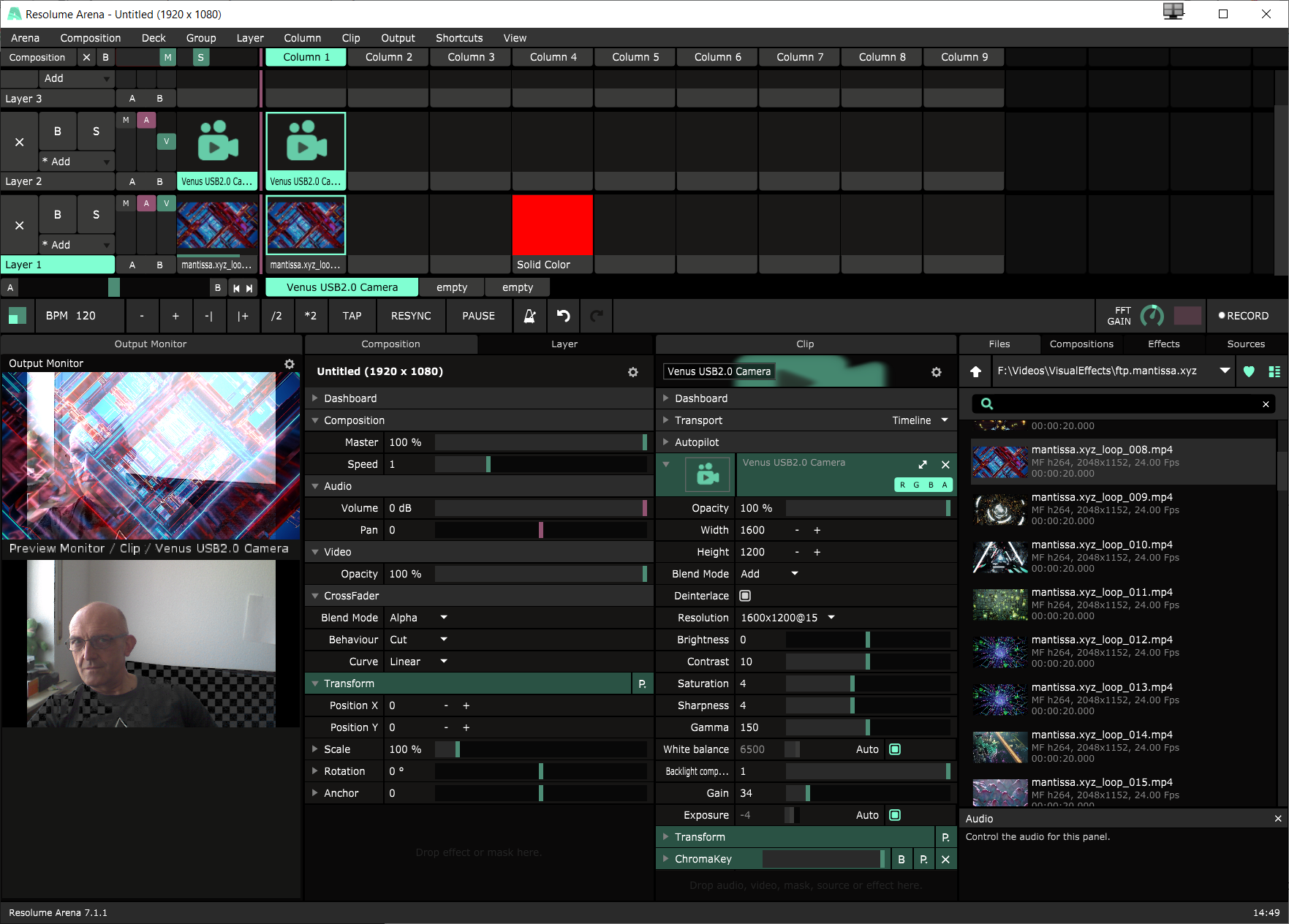

This does what it's supposed to do:
It adds the clip to the cam view, what means the clip fills the whole screen instaed of the keyed parts of the cam picture
cam with chromakey effect

are you sure your opacity of (cam)layer is at 100%
You may can post a screenshot of the whole gui with the 2 clips playing and the preview (cam) and the main out (both)

Interesting is when I enable the option "show mask" in chromakey, you can see the clip is shown in the output (everything else is white). Are you sure "add" is the right blend mode ? However I tried multiply and

to make things perfect you may be right. But I have a more principal problem. You can see in the first Image, the blue area has been detected properly and is shown as checkert area. Now what I expect is that this checkert areaa should be replaced by the video clip.
This is only a proof of concept (and a very lousy trial) and I don't complain about the quality of the effect but of the functionality of chromakeeing at all (forget the second image, it confuses what I'm trying to explain mor than it helps)

The opaccity of the layer of the cam is not 100%... so the croma key cant be 100% as well....
As well your chroma key is set to blue so its trying to key blue ;)
play around with the color & threshold and you may get a better result...

Opacity of the Layer and the cam are both 100%
My problem is NOT that it's not good, my problem is that it's not working at all .
I see the clip on the whole screen instead of the keyed area, and there IS a keyed area and yes, it is blue that's right (because the couch in my background is blue, and that's my test object)
See the checkered areas, in this case the couch and my shirt, both are blue, both have this checker texture after I adjusted the chromakey colour (which means the colour matches), and exactly theese areas should get the clip, but as you can see
in output view, the clip is everywhere !
I guess, once more that the blend modes have to be changed, but here is my problem : which blend mode setting or whatever on which object (cam, clip, layer , whatever) has to be changed
I think "add" is is not the right setting...

In you screenshot (post 9) The fader of the layer is NOT at 100%.... pls dubble check this first.
Layer 2 / V-Fader (opacity) / 100%
If its not what you need i prmoise i do some test and post some screenshots as well to get you through..
