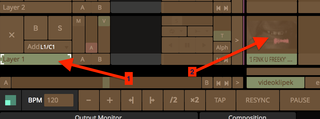

There is the Active layer Clip target option you can use to launch a clip in a specific layer.
First you'd select a layer, with a shortcut assigned to the layer name handle
then trigger the clip with another shortcut.
