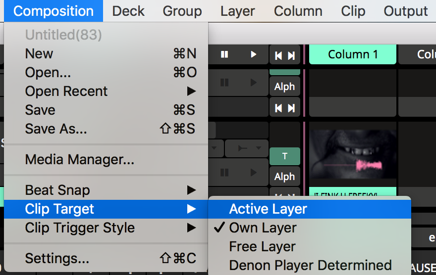

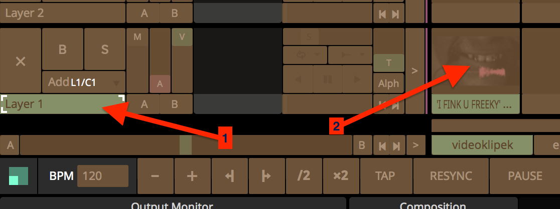

There is the Active layer Clip target option you can use to launch a clip in a specific layer. First you'd select a layer, with a shortcut assigned to the layer name handle
then trigger the clip with another shortcut.
If you already have your clip loaded in a deck, you can select and launch it via Art-net.
