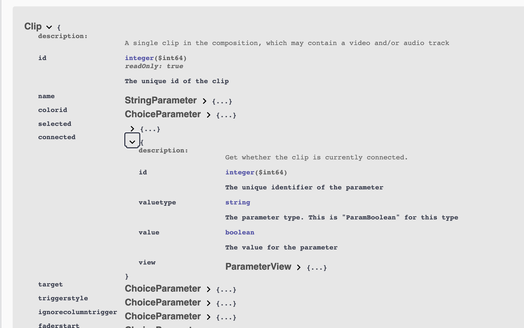

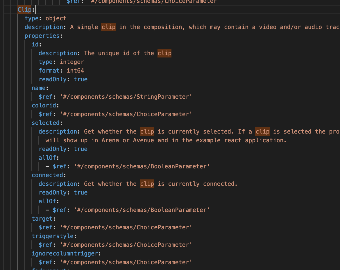

I guess "Clip" has incorrect type.
layers.clips.connected type should be "BooleanParameter" but it has "ParamState" type, which is not defined in swagger.

https://user-images.githubusercontent.c ... 3e122f.png
https://user-images.githubusercontent.c ... ac7800.png
https://user-images.githubusercontent.c ... fbf9c3.png

A clip slot can be connected multiple ways, like the list explains. It should not be a bool.

I see, okay then I need correct swagger yaml for generating correct typed codes.
The problem is not if its bool or not, it is different type from swagger.yaml's type definition.
My Go project codes are generated automatically by reading swagger's types, so if type is not matched my code will be broken. Otherwise I have to fix them by myself, which means swagger is not working.

Hmm, I see what you mean now.
I'll make a ticket.
