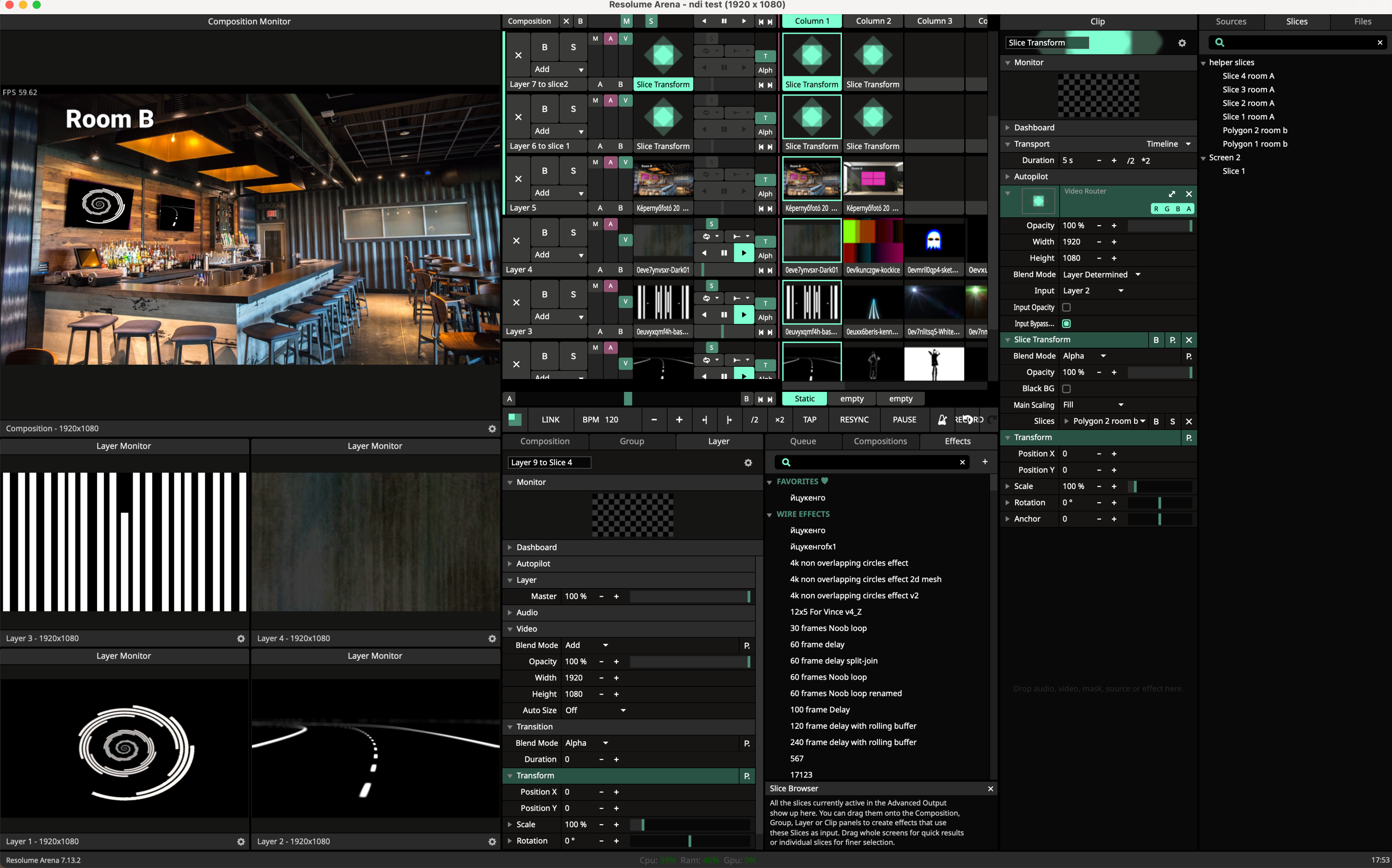

So I'm using Arena for what I would imagine isn't very common...

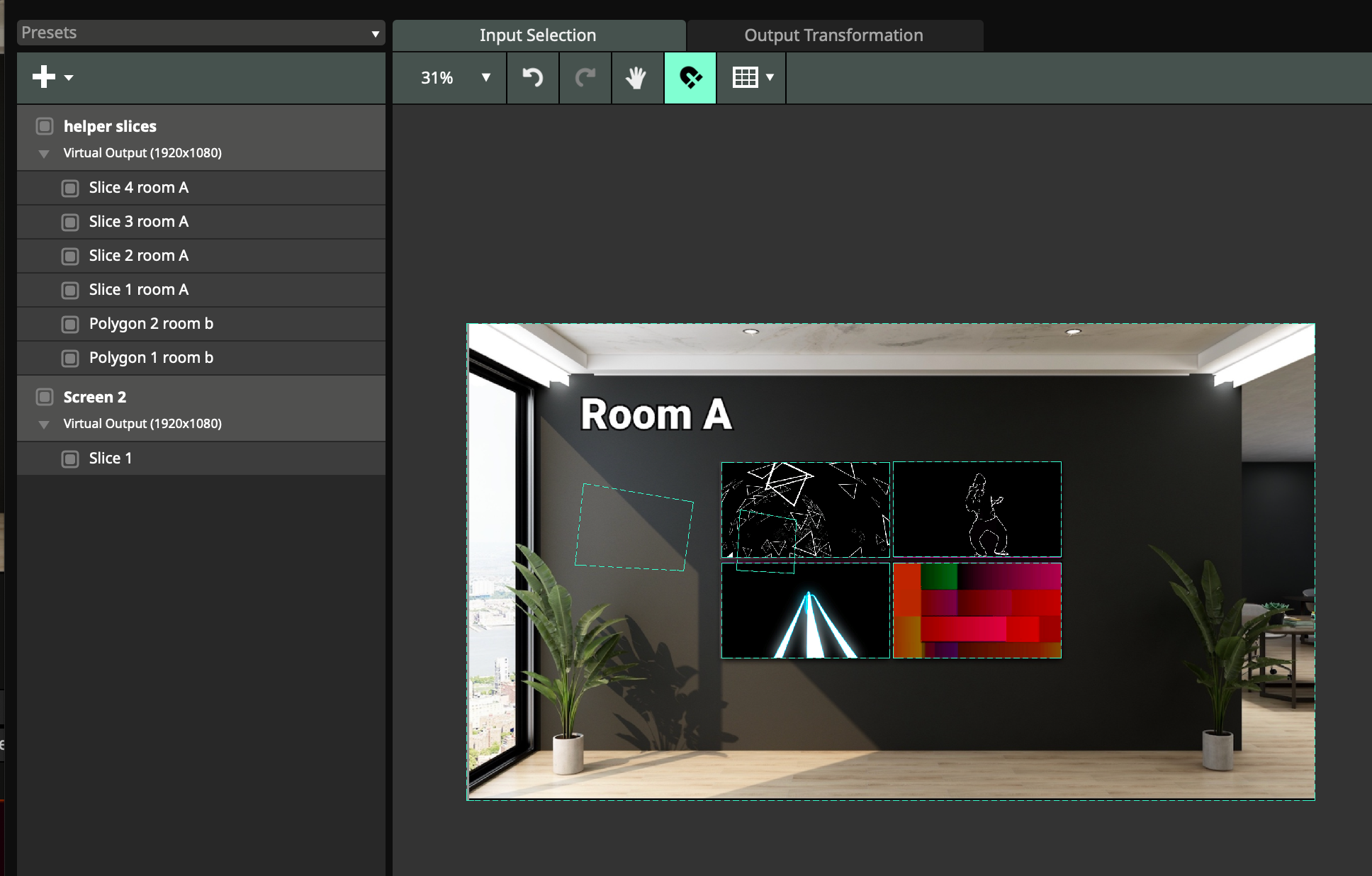

I am displaying various rooms with televisions in various positions and angles. The rooms are PNG's with transparent areas where the screens are. Underneath this room layer, I have 4 Slices displaying live feeds from 4x HDMI input cards - all aligned to their respective display in the room.
Right now when I want to switch between rooms, I have to switch the HDMI sources to invisible, select a different room image, open Advanced Output settings and change the preset to the corresponding room, then change my HDMI sources back to visible.
Does this make sense to anyone? Is there a better Resolume Guru way of doing this - potentially controllable from the WebUI?
I've attached an image of 3 'Rooms' with the pink areas representing the transparent spots where the slices would be visible underneath.
Not the typical use case - switching output presets

I'm using Layer to Slice routing but I'm not clear on how to switch between the different necessary arrangements of the Slices efficiently, for example going from the 4x straight on Slices in Room A to the 5x angled/perspective slices in Room C. Thoughts?

The solution I came up with is just to have a boat load of Slices in my Advanced Output config and a boat load of layers. Still unsure if there is a better way, the one thing I can think of that would massively simplify this is if Advanced Output config Presets could be switched on the fly.
Re: Not the typical use case - switching output presets
You can do that with Slice transform. Just map the bypass toggle for each slice transform (think of each instance of slice transform as a "look")
