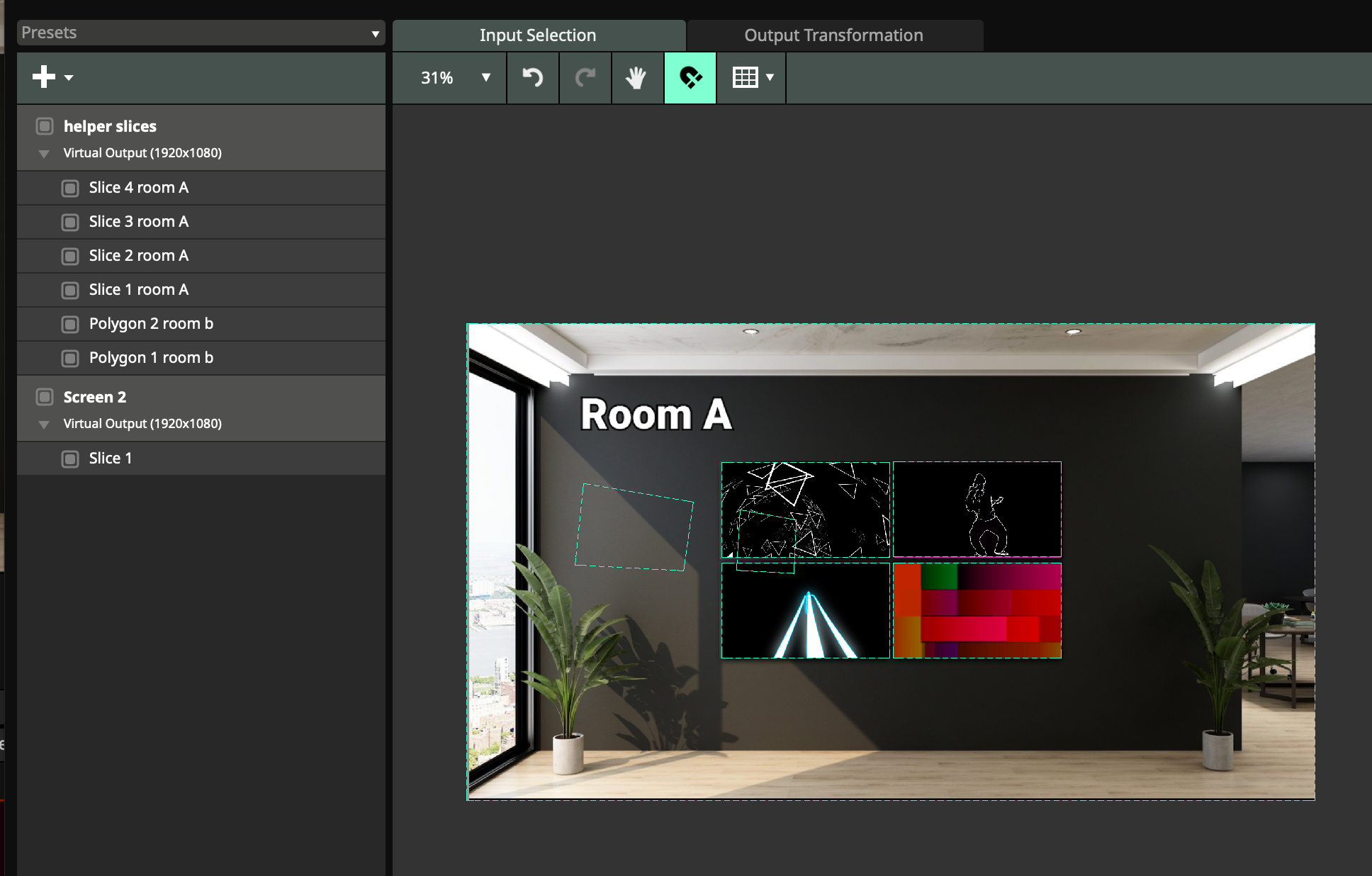

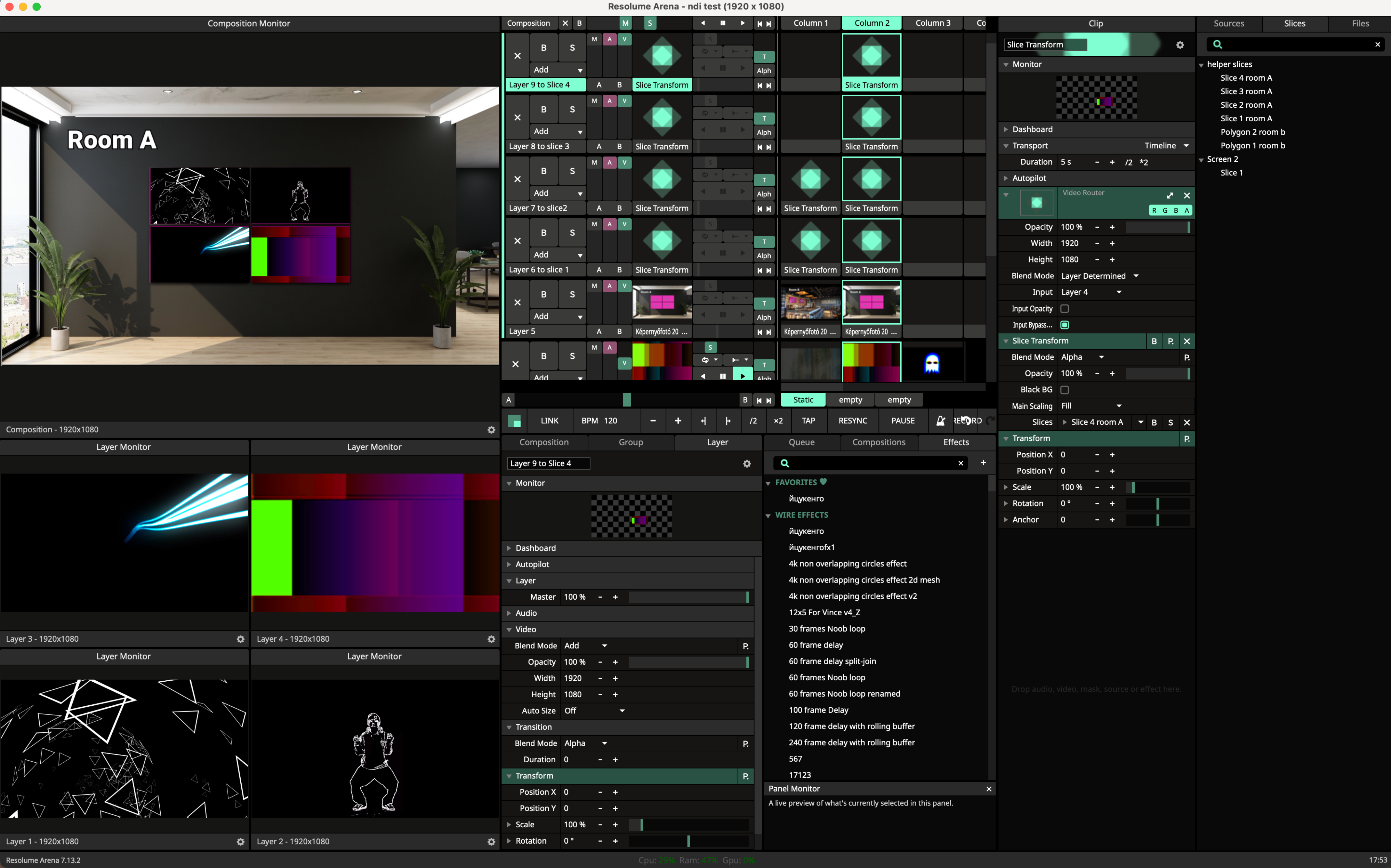

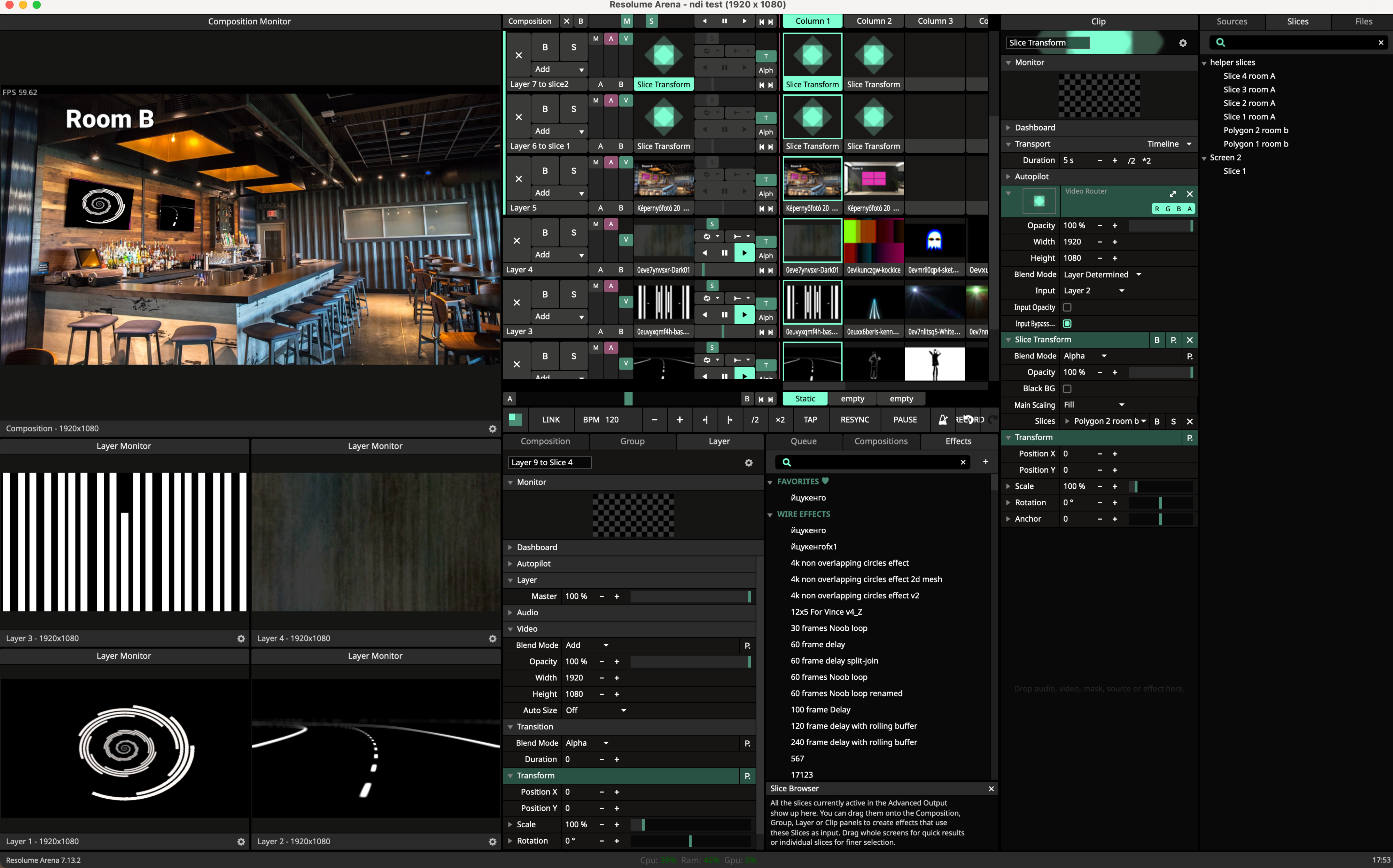

Hmm, yeah, StageFlow can give the perspective then for the slices, but you can get pretty close natively too

The solution I came up with is just to have a boat load of Slices in my Advanced Output config and a boat load of layers. Still unsure if there is a better way, the one thing I can think of that would massively simplify this is if Advanced Output config Presets could be switched on the fly.
Re: Not the typical use case - switching output presets
You can do that with Slice transform. Just map the bypass toggle for each slice transform (think of each instance of slice transform as a "look")
