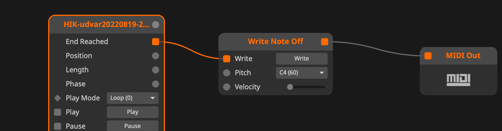

Im working on project a user interactive display.
Where user is given a iPad and aksed to answer few questions.
As per the user answer the Graphics will change on the display.
All the user selections will reflect as midi in the Resolume wire.
Midi in I was able to patch and tested, working fine.
But the challenging is I have to send a midi out trigger saying that the video is ended.
How can I do this.
How can I do this.

Re: Resolume wire Midi out
right click on the video player, visibility, show all
