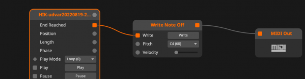

But the challenging is I have to send a midi out trigger saying that the video is ended.
How can I do this.

Re: Resolume wire Midi out
right click on the video player, visibility, show all
then
