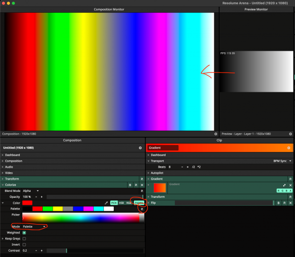

Yes shure, that is definitely possible in the colorize effect. You can also choose pallets as a color Source.
It will split your footage in different gray values, depending on how many colors there are in the pallet and then it will replace those gray values with the colors of the pallet. The color on the left side will be replacing black and the color on the right side will replace white everything in between will replace the difference. gray values. I hope that helps.

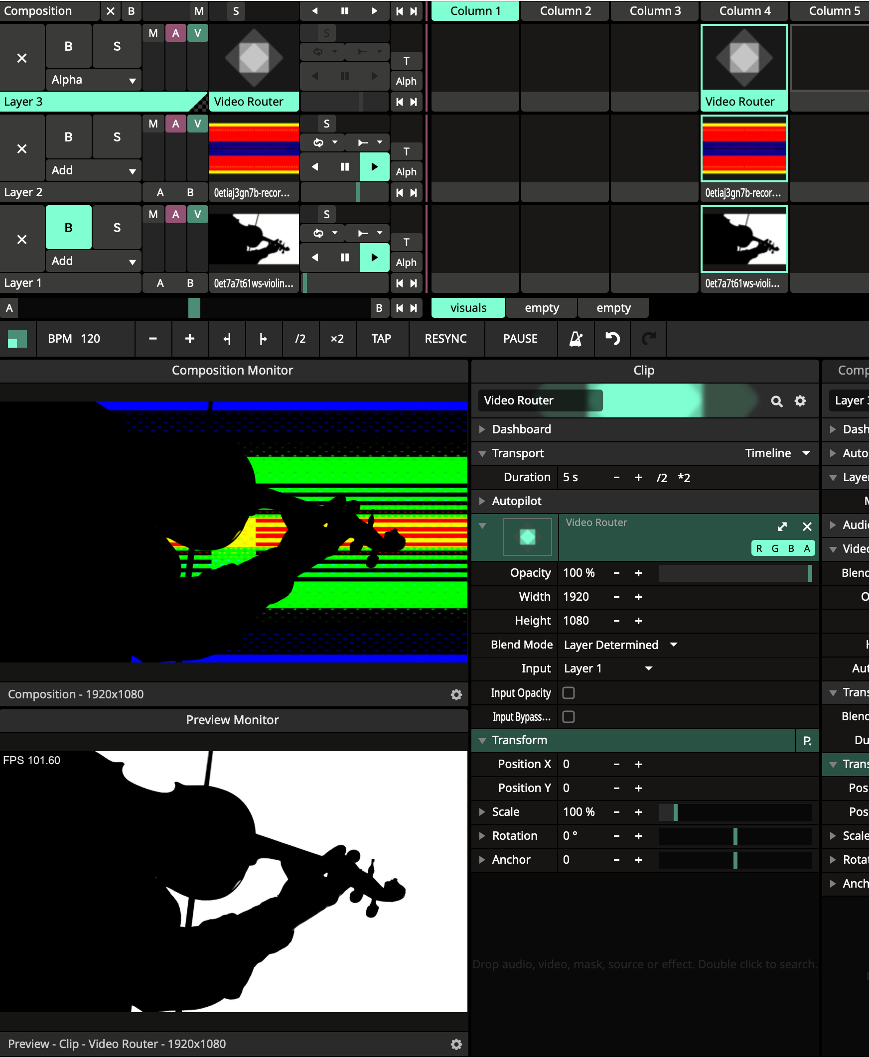

You sad that before, but what do you mean by that? if they are bypassed you won't see them right? so you cannot change color either... Can you maybe share a screenshot or something?
Re: Gradient as color overlay
Video router can take image from bypased layers, and you could play that router in a masking layer.
But you can also just play the b&w clips in a masking layer directly.
