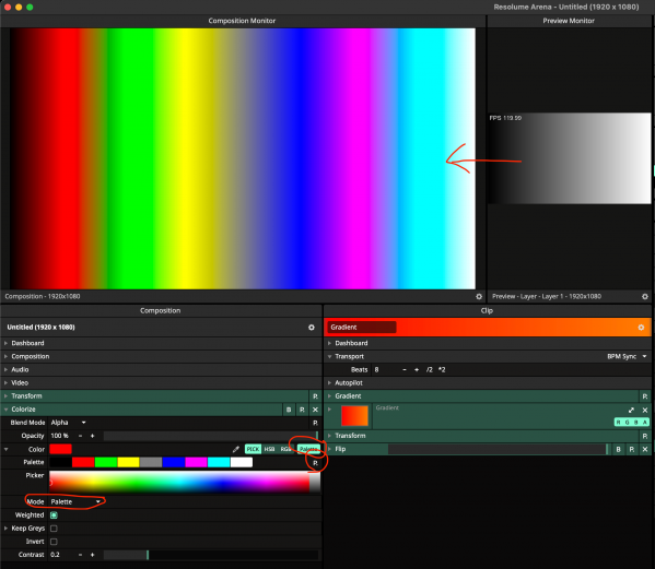

Yes shure, that is definitely possible in the colorize effect. You can also choose pallets as a color Source.
It will split your footage in different gray values, depending on how many colors there are in the pallet and then it will replace those gray values with the colors of the pallet. The color on the left side will be replacing black and the color on the right side will replace white everything in between will replace the difference. gray values. I hope that helps.

I like the magma gradiant presets with a hue rotate behind it. Especially nice if you changed the Hue on every layer....

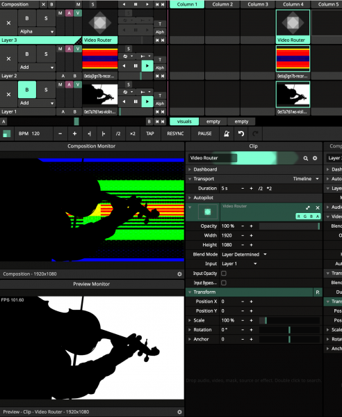

instead of moving the pallet colorize effect to the layers is there a way to apply the gradient to the layers? the gradient is a source not effect though

How about tusing the B&W footage to mask the gradient source?

this would work but my two b&w layers are both bypassed

You sad that before, but what do you mean by that? if they are bypassed you won't see them right? so you cannot change color either... Can you maybe share a screenshot or something?

Video router can take image from bypased layers, and you could play that router in a masking layer.
But you can also just play the b&w clips in a masking layer directly.
