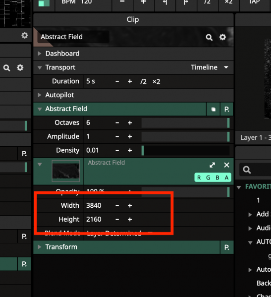

I've found that a Wire patch will automatically detect the composition resolution when it's added to the composition, but it doesn't update if the composition resolution is subsequently changed. I need to remove the patch and add it again for the resolution change to take effect, which loses the current settings, automations, etc. (unless they're saved as a preset).
Does anyone know if there's a way to make a Wire patch read the composition resolution in 'signal flow' so that it detects resolution changes on-the-fly and updates itself?

It will not automatically update the size of your patch, but what you can do is change the patch size manually. In the clip panel under the name of your patch, you can set the width and height to match your new composition size.
I hope this helps you out...
