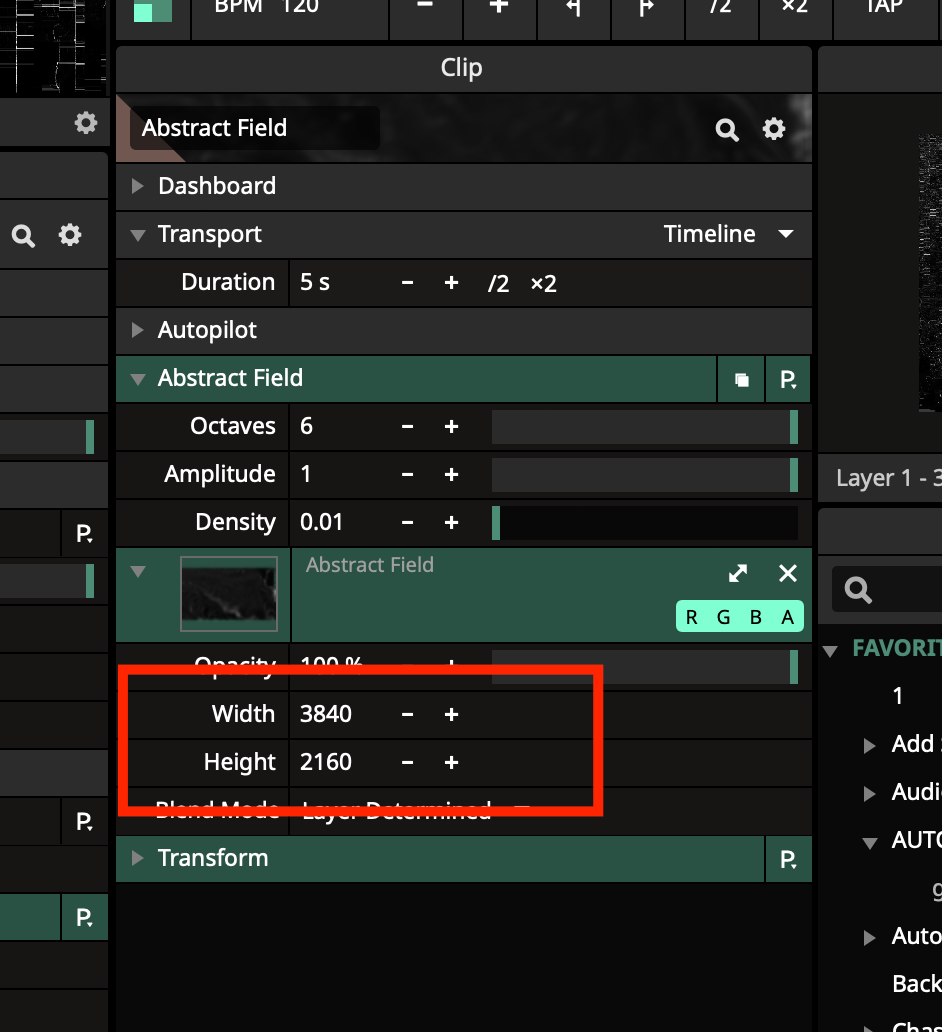

tijnisfijn
Posts: 355
Re: Resolution questions.
Post by tijnisfijn »
It will not automatically update the size of your patch, but what you can do is change the patch size manually. In the clip panel under the name of your patch, you can set the width and height to match your new composition size.
I hope this helps you out...
