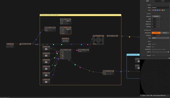

As for the attempt at selecting a different video every time this is used here is what I found (does not work)
I thought I could use an "equal" node to trigger a true value once the transition hit 1 which should only occur at the very end of a transition.
This would then hook up the the generate port on the "random" node, which would then select a random integer between 1 and 6.
However, for some reason these nodes don't want to connect to each other and I am not sure what the issue is. The ports are different shapes so I am thinking it is a data type issue.
Will keep trying as I learn more about Wire.

Indeed, that was more difficult than it looks because the video resources are attribute flow. They cannot rapidly change, but I found a workaround that works quite well. I hope this does what you want. It also has a button to randomized the play direction. Have fun with it and enjoy.

Following up on this. Thank you immensely for the patch. The flow inside is much more than I would have anticipated.
With that said were you able to get it to work? I unfortunately was not. It does not show any of the videos I loaded into it.
As it is now the transition hard cuts to the next clip, then 0.5 of the way through goes back to the first clip, then when finished cuts to the 2nd clip again.
Is there any kind of formatting I would be expected to do different than the other versions of this?
Let me know if a video of this or if sharing the alpha files would be helpful in collaborating on this.
